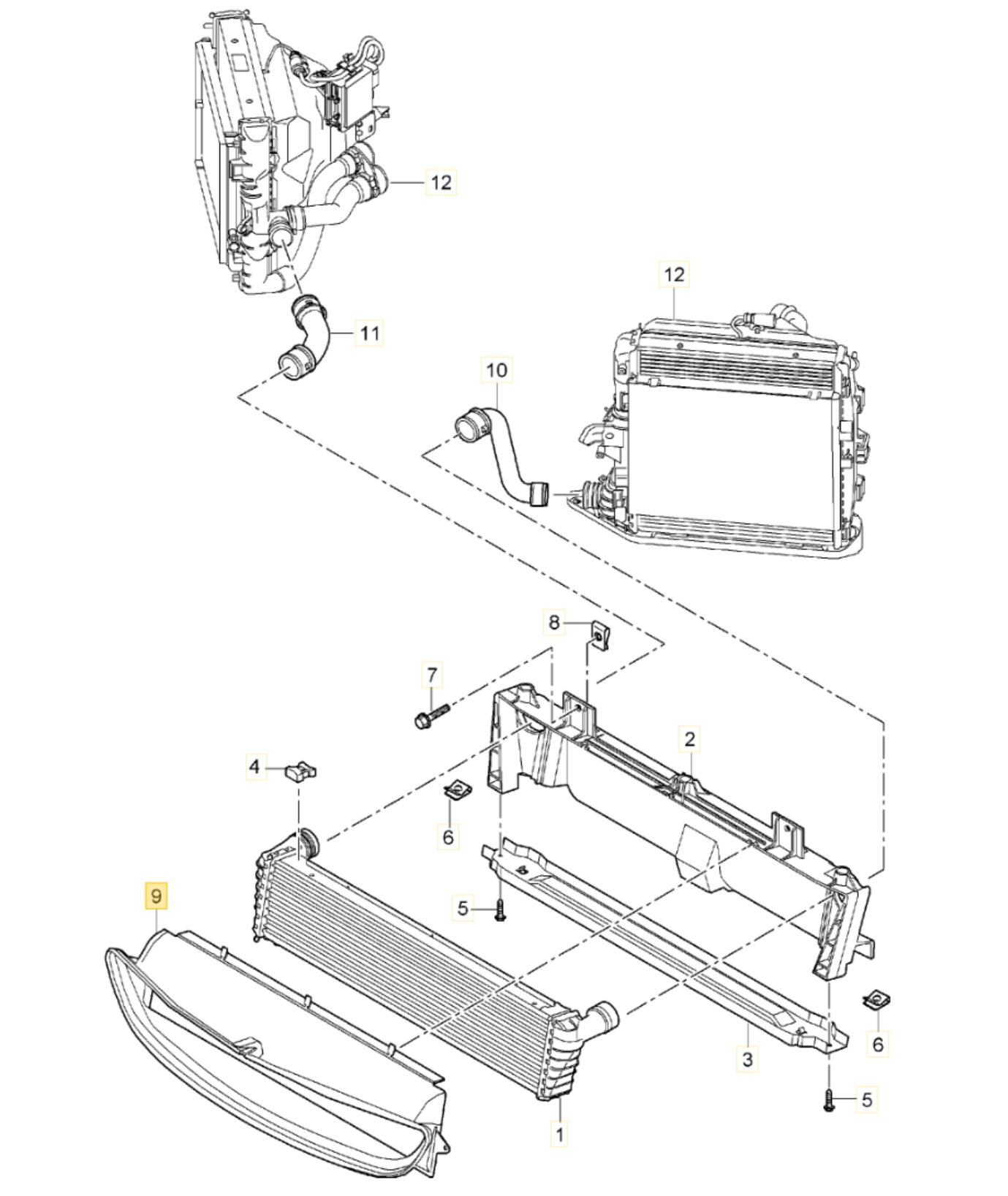

Hi all, Picked up used center radiator for an upgrade for my 08 boxster. I have the radiator, 2 hoses, bracket, aluminum support and the shroud. My question is if there's a trim piece that holds the Rubber shroud to the bumper or does it fit thru the opening of the bumper without any extra hardware. Thanks v
Ok ...so it just sits in the bumper cut out... no finishing trim or anything.
PN's 987 505 551 00
         987 505 555 00
         987 505 751 00      are these the parts associated with the trim for the bumper cover?
