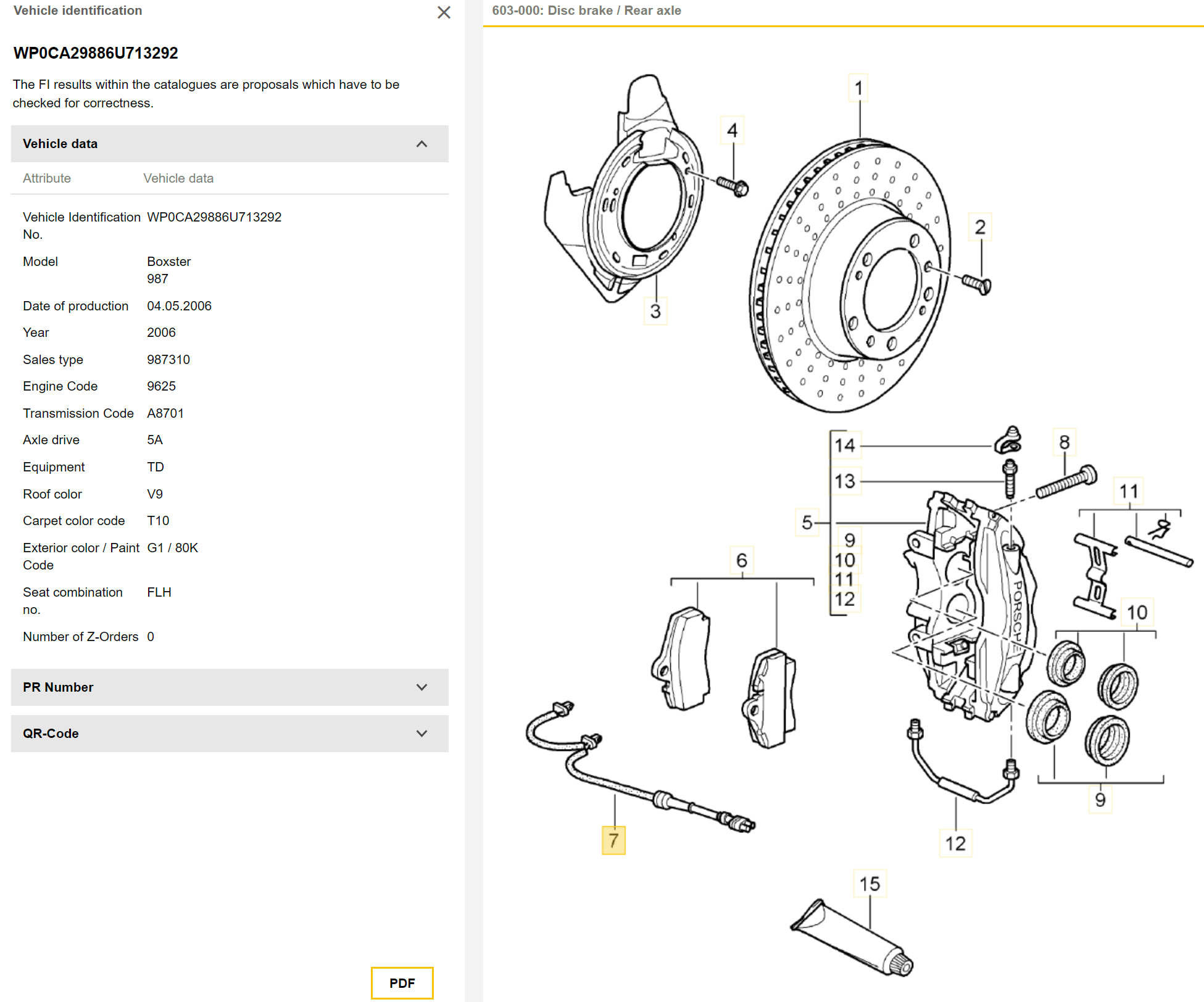

I have the correct replacement rotors and pad; my question is whether brake pad sensors are universal.
From both the Pelican and AutohausAZ web sites several brands are available: Serb, Sadaca, Pagid
Do all these pretty much fit ?
 WPOCA29886U713292
Edited by jim_hoyland
Left Front sensor -- 997 612 755 01   sender wire (pad wear indicator)  US MSRP $59.28
Right Front sensor -- 997 612 757 01   sender wire (pad wear indicator)  US MSRP $59.13
Sensors include cable and connectors... item 7
Rear (same for both sides) -- 987 612 676 02   sender wire (pad wear indicator)   US MSRP $35.64

1 hour ago, jim_hoyland said:
Thank you, good diagram. Just watch several videos on pad and rotor replacement.
Are the caliper bolts 55mm torx ?
 Maybe..................the factory bolts were 10MM hex drive, but the factory replacement bolts are T55 torx; torque spec for both is 85 Nm/ 63 ft-lb.  You should not reuse the bolts in any case.
