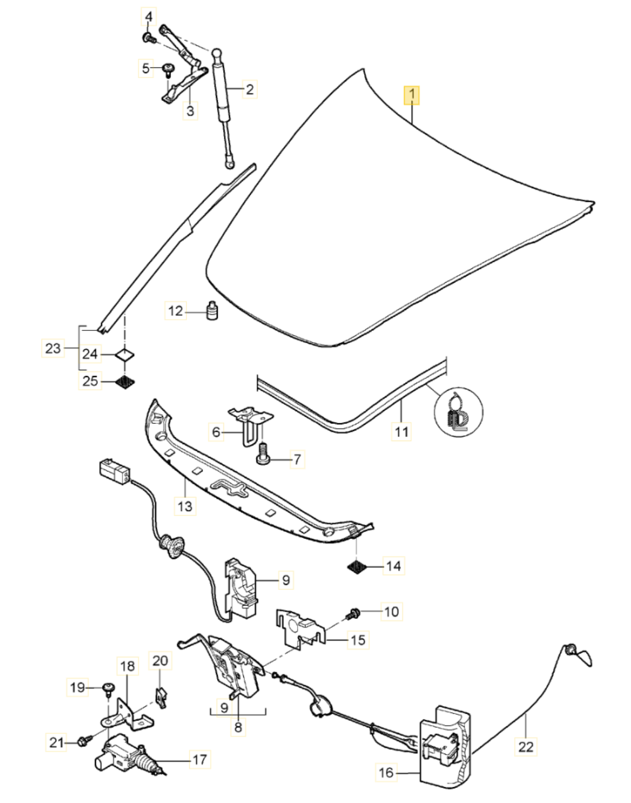

Hi All,Reassembling my painted 08 Boxster and found my frunk release isn't working. Car had front end damage so I replaced the damaged actuator with a used one. Is there a way to troubleshoot the actuator and the switch on the sill. I don't hear any sound or clicking on front or back latches. Do they share the same fuse? Fuse numbers would help as well. Thanks
I'm getting continuity on pins 3 and 6 when the trunk switch is thrown. Nothing else when the frunk switch is thrown on any other pins. I initially thought both weren't working but ill double check see if the trunk works. Otherwise I assume its a bad switch.
Edited by vza
Confirmed ....new switch needed. Two more questions....The frunk actuator dosent seem to get bolted in anywhere. Does it just sit behind the liner freely? And...the emergency Frunk cable(cable from another actuator on the passenger side of the release) ...does the cable connect to the secondary hood release? Thats what I've seen online but dosent make much sense to me.
