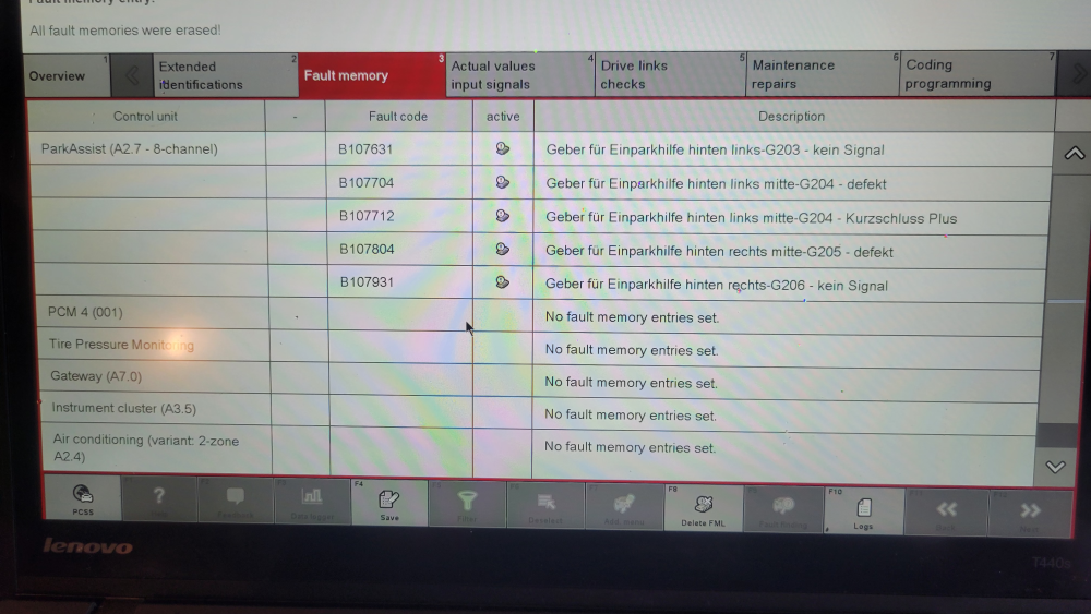

Please use a Porsche-specific scanner.  Kidding!!!  If you can't set it to english I can have my wife translate all of this stuff for us 🙂
It's telling you in German that there is an issue with the parking sensors.  kurzschluss basically means short circuit on the G204.  The G203 and G206 are getting no signal and the G204 and G205 it is saying has a defect.
Sensor for Parking Aid; Rear Left (G203)
Sensor for Parking Aid; Rear Mid-Left (G204)
Sensor for Parking Aid; Rear Mid-Right (G205)
Sensor for Parking Aid; Rear Right (G206)
