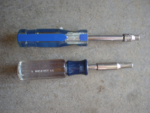

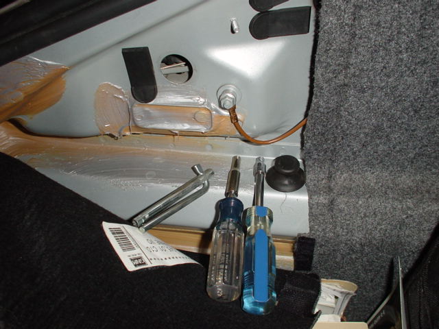

OK, the litronics showed up today, but I don't have the tool pouch, just a jack, spare, and jack handle, tow hook. After looking at the place where I am supposed to give it a 180 turn, it looks like a 6mm socket fits right on there. I've turned it 180, then back and forth about 90 or so each way, then completely 360 and more. It doesn't seem loose at all. I'm so confused. :help:
The Porsche tool is a a T-handle so it will take some force to unlock it. It will snap to unlock and snap to lock. As I recall turn it towards the front of the car to unlock.
When you put the Litronics in make sure it snaps locked. You should not be able to move it when pulled on - if not they will come flying out the first time you hit the brakes hard. :eek:

I contacted the local dealer here and they said 5mm and it has to be a DEEP socket also, which may be my problem getting the light out. Then they told me I can't just plug in these new lights, but that I need an install kit with a new wiring harness and control box, and other things. I was under the impression that I could just plug them in and the only thing I wouldn't have is the automatic leveling. Is this correct?

Well I used a 5mm socket instead of 6mm and it was less than a 5 min job. :clapping:
Thanks TP for the advice!
Also, Dell I appreciate your offer to help since we're both in Vegas, but there was nothing to it once I got the right size socket... :thumbup:
