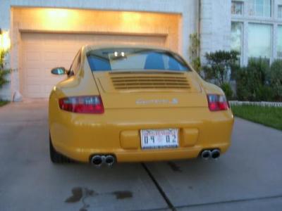

I have the same shifting issue .. I have to bring the rpm down to 2 3000 from 4000 inorder to do a smooth shift for both 1st and second gear .. i had almost the same issue with my 996 and i almost fixed it by changing the transmission oil to mobil 1 synth . any other ideas ???. should i try changing the transmission oil .. my car only has a few hundred miles now ...My Webpage

Take that new yellow beauty to the dealer and have them fix it! You should not have to deal with this, the car is under warranty....
