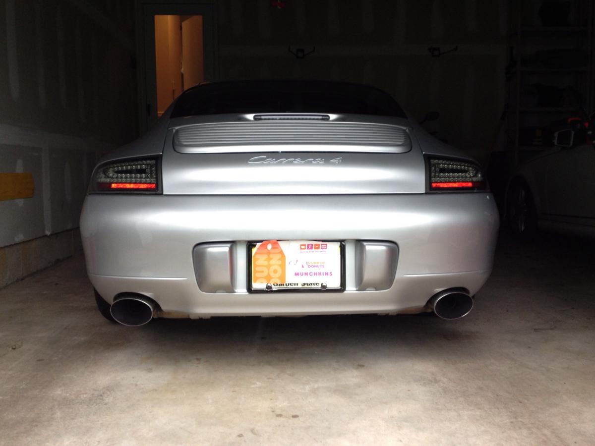

I picked up a MY03 set of PSE mufflers with 31K miles. Almost new condition. Easy install with the DIY instructions. The mufflers I got came with tips, but the MY03 tips are too long and low for a MY01 IMHO. I ended up using some Tubi tips I picked up on ebay, which look great. The sound is, of course, perfect.
Share this post
Photos? :clapping:
Share this post
Photos? :clapping:
post-82817-0-02091900-1369479843_thumb.j
post-82817-0-38194000-1369479952_thumb.j
post-82817-0-75949800-1369479955_thumb.j
