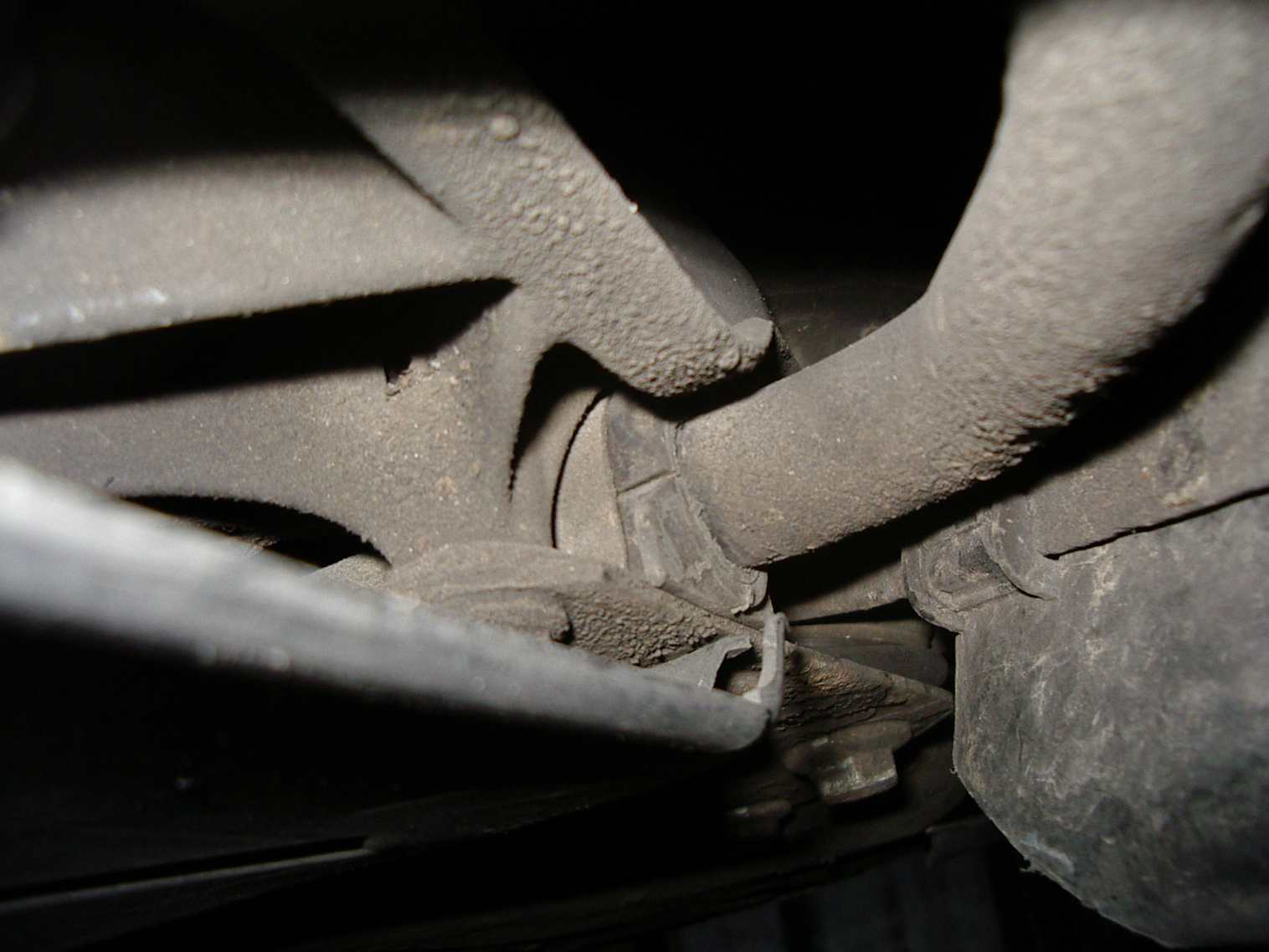

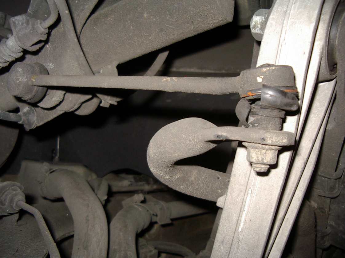

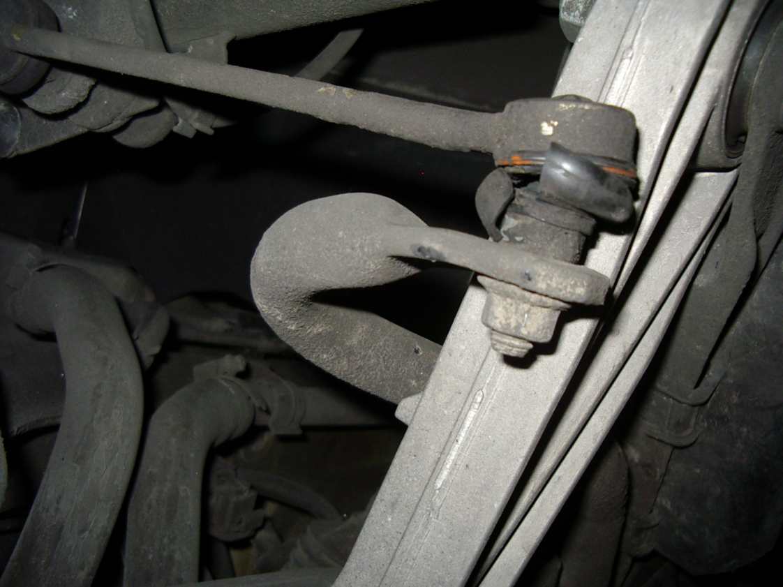

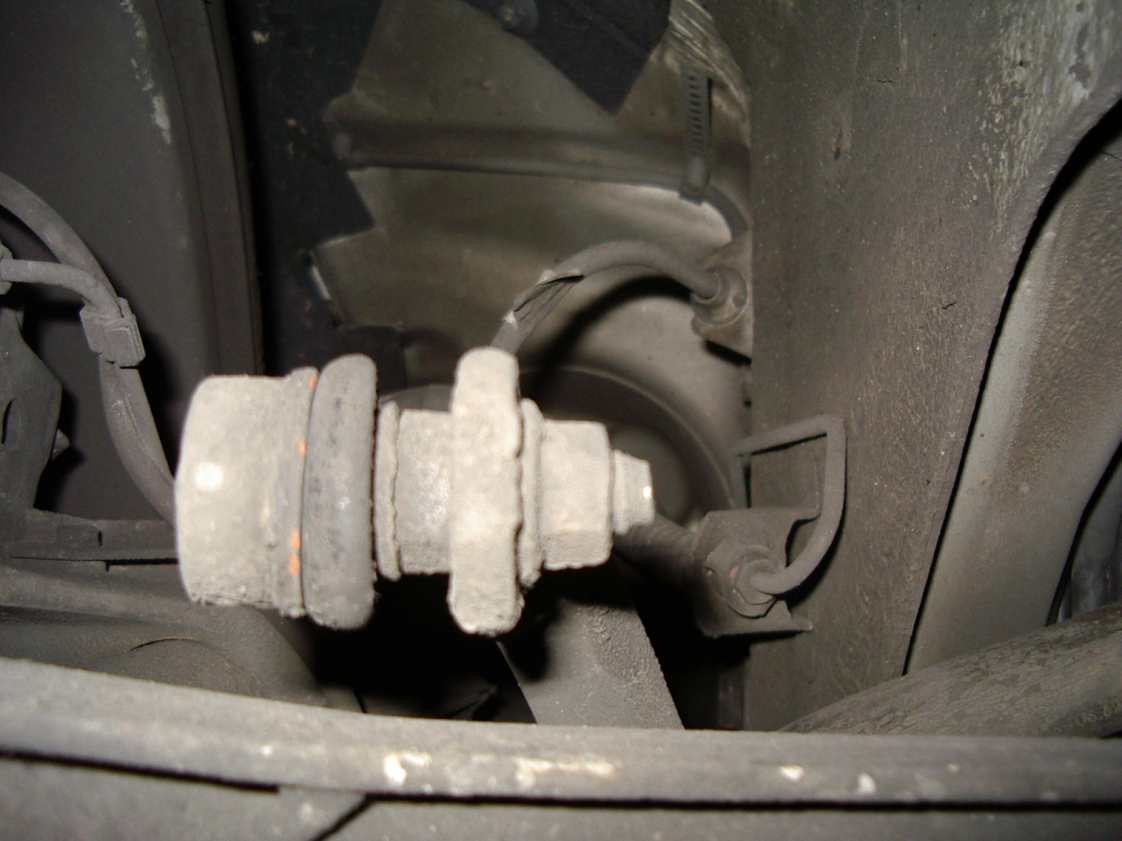

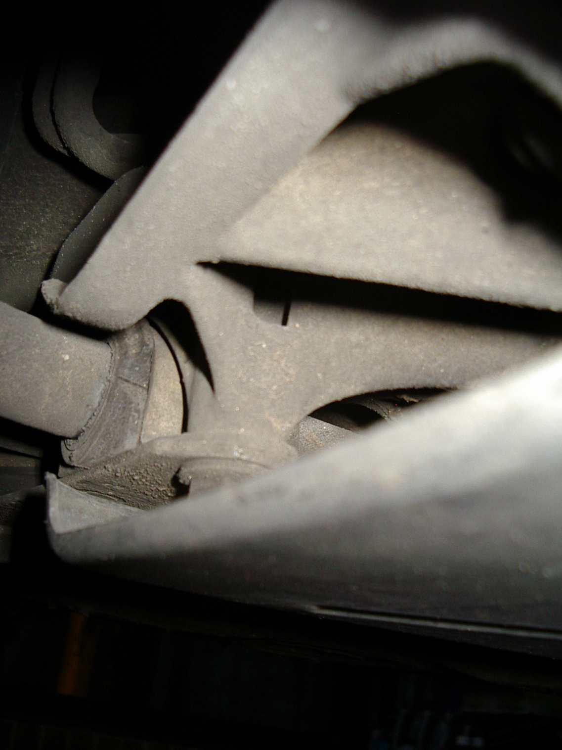

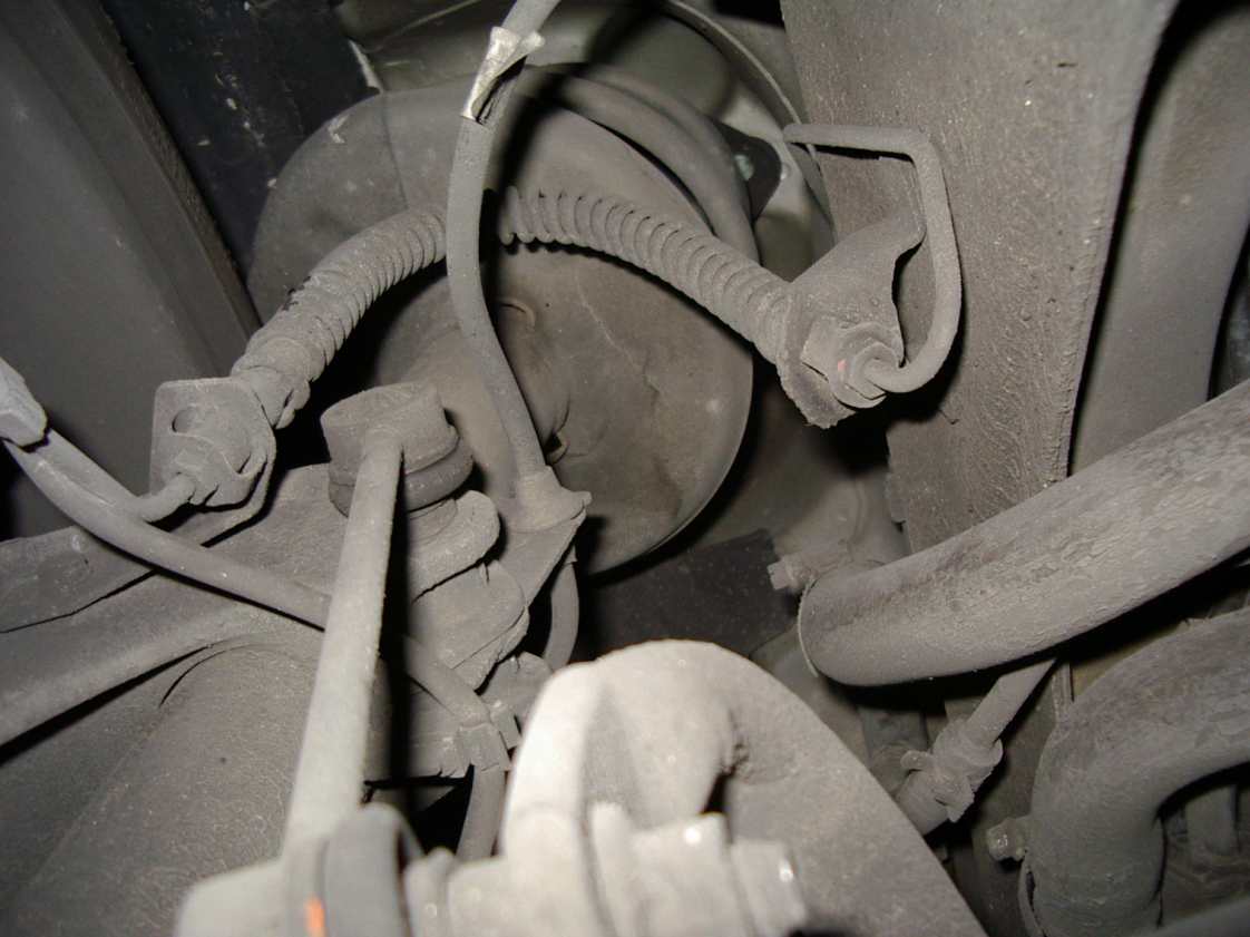

Can you post a pic or two of the drop links and the main bar bushings (mounts)? I still think your mechanic meant the main bar bushings.
Sorry about the lateness of reply, Loren. I just had a chance to get the car up and get under it today. Here are the pics:
Australian passenger side (US driver side):
post-1432-1130407129_thumb.jpgpost-1432-1130407189_thumb.jpgpost-1432-1130407222_thumb.jpg
Australian driver side (US passenger side):
post-1432-1130407256_thumb.jpgpost-1432-1130407282_thumb.jpgpost-1432-1130407324_thumb.jpg
I suspect the broken rubber bushing on the (OZ) driver's side is what my mechanic may have been talking about. Although does a broken bush in itself really cause trouble? I thought it only acts as a dust cap to the joint.
I tried to axially twist the drop links today - neither would move. The difference between today and the last time I tried it was that I only jacked up the car on one side today - both wheels are still touching ground. Wheels were off the ground when the drop links could be twisted axially by hand last time.
Also, the (OZ) driver's side drop link looks a bit bent towards the sway bar end. Could that be causing any problems in my suspension? Is the function of the drop link to send force up/downwards?
Edited by Jinster
Very unusual... I wonder if something hit it?
I think you are going to have to replace the drop link on that side. You might want to consider replacing both so the wear is even.
