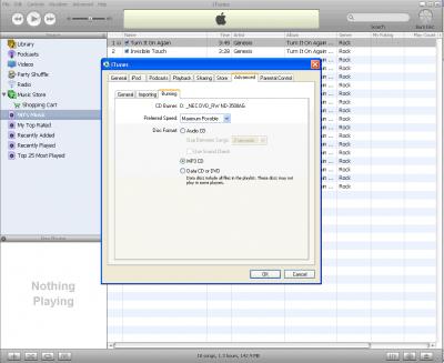

Can anyone enlighten me on what this mp3 playing function is.
I have mp3 files , a cd burner , Itunes and an ipod ,but am unfamiliar on how to utilize this function in pcm.Do I have to burn mp3 files on a disk?
I am told that a disk can hold hundreds of files ?How do I do this?
Easy. Create the playlist that you wish to burn. Go to Itunes>Edit>Preferences>Advanced>Burning and select MP3 CD. See attached image.
Then burn. ;-)
Then burn. ;-)
