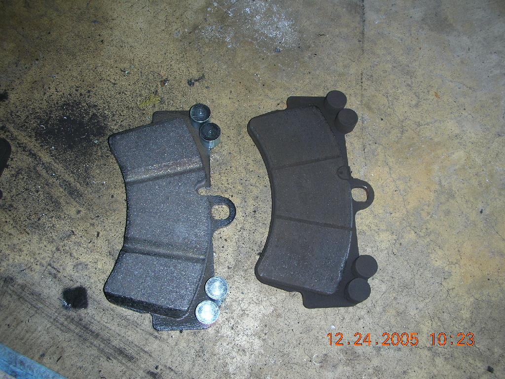

First, let me say that when I took the pads out the rotor looked fine and although I have slotted drilled rotors to put on I did not see the point in wasting them they will go on next time.
Total elapsed time including jacking, wheel removal and the job itself was 90 minutes

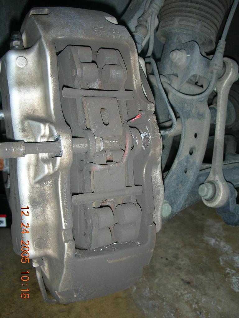

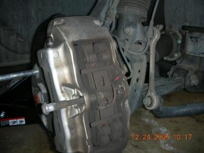

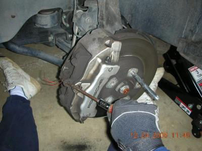

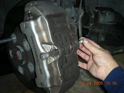

A single bolt hold the pad retaining pin in place, as usual with fluid locked bolts tighten a fraction to break the seal and then remove as normal.
Leave the bolt in couple of turns and tap the end to start the pin on its way through.

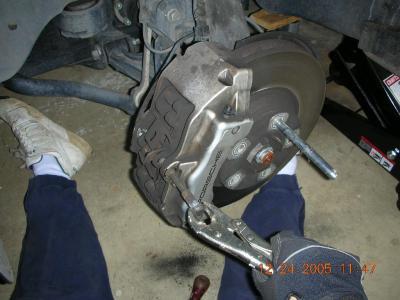

I used a broad flat screw driver as a drift to knock the pin through and a mole grip to pull it through. Its a pain to get through I warn you.

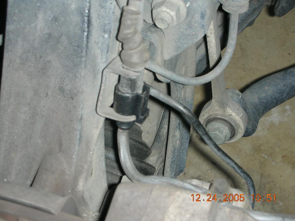

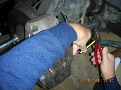

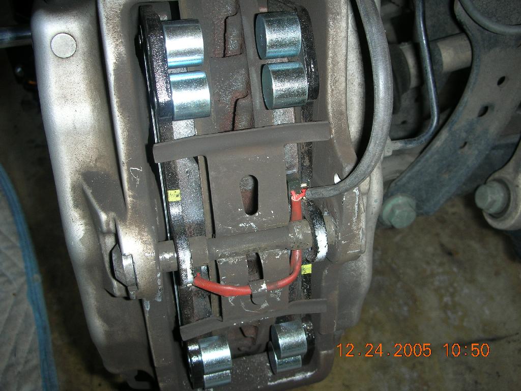

Once the pin is out, break the sensor wires , its easier.
Use a driver to lever the pads out.
Removing the old sensor cable was hard so breaking the connector seemed easier. Route the new cable to the connector and behind the little loop on the brake nipple rubber cover.
The sensors clip in with the thick part pad side.

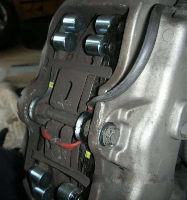

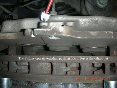

To get the new pads in you will find that depressing one of the pistons is easy, the second ok the third forces out the other 2.
I found the easiest way was to depress the first 2 and then slip the pad in, with the pad bkocking the first 2 depress the third and push the pad into place. Its not hard just fiddly.
You really need three hands to put the pin back through. The best way is to depress the pad retaining spring and tap the pin through, for the last part you will need to push the pin itself into line.
Dont forget to get blue loctite for the pin bolt and brake grease for the back of the pad.

Can you tell me how to disconnect the brake wear sensor wire. I couldn't get this part disconnected and may have broken the connector. Is there some trick to it, Please advise.. thanks.
1 - I use Hawk dustless pads now
2 - very carefully, bend the u clip attached to the strut and squeeze it out then pull it apart while sliding a small flat bladed driver ito the clip
Mudman2:
When looking at the picture of the clip the way it is, Can you tell me do you insert the flat screwdriver from the top or from the bottom of that tab that is facing out.
I tried to lift that tab from the bottom side and even with a good deal of force, the wires did not separate, and the tab eventually broke.
if the tab broke its no sweat really but if its clear of the clip it will pull apart, its tight.
