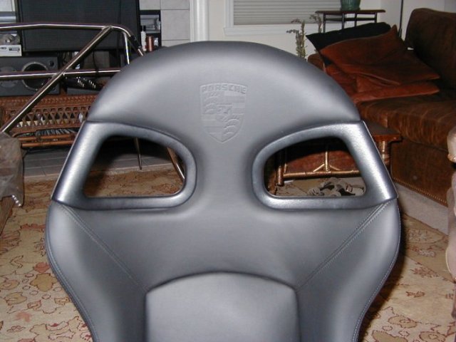

Thanks for the DIY. I installed fabric seats today. The only trouble I had was with the electrical connector. I discovered that the whole connector can be removed from the seat by pressing two small plastic tabs and then sliding the unit off the seat. This is a time savings as it allow you to closely examine the connector to discover how it comes apart. To disconnect the connector, there are two clips that need to be released. The first, on one side, pulls out only partially and releases the two main pieces of the connector. The second smaller one on the other side releases the small seat belt sub-connector. Finally, the fabric seats have clips installed on the bottom which accept the seat belt wire so you can keep things tidy.
