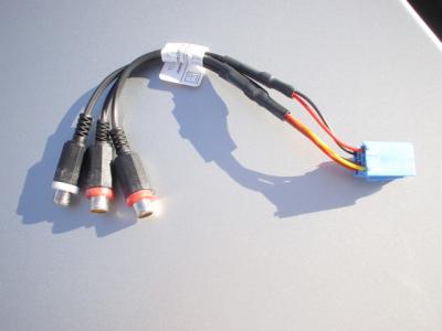

I'm investigating putting in the Becker Aux connector for my MP3 player.
Any success with a connector for an MP3 player?
No, I'm waiting for a BlueTooth reciever for the PCar, lose the wires, and connect my cell or PocketPC to it instead. It will be cleaner (without wires).
As for the $16 Becker harness, it looks very simple:
1- Yank stereo
2- Unplug Blue harness (keeping the line from the required cd changer)
3- Add new Blue harness
4- Fish cable around to where you can reach it.
If you've figured out how to get the radio out with the Becker tool, the operation appears to take less than 10 minutes and you're good to go.
PM Toolpants just in case I'm wrong.
1- Yank stereo
Does this work for a MOST stereo?
I thought there wasn't an easy way to get auxiliary input for these MOST stereos.
