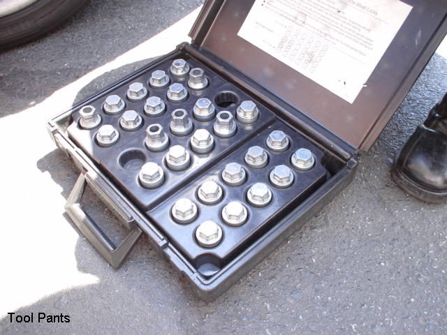

Never seen that few, or that much. For the 996/986 locks it was about 30.
The lock style changed for 987/997 and I do not have a picture of that kit.

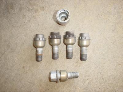

Hi again all. I was wondering, since my closest dealer is over an hour away, can they, by chance, determine locking lug pattern by VIN? Thought perhaps I could order and save a trip. Or is there a way to remove them without the "key" and just replace with regular lugs? I may change wheels, and theft isn't a large concern (car doesn't get out much). Thanks as always for all the wondeful help & advice!!!

They are not related to the VIN, and may have been changed during the life of the car. A local INDY may have a set.
I also say the wheel locks are not related to the VIN.
If your car no longer has the "key" then you might remove them and put in standard wheel bolts. Have your dealer remove them and buy 4 new standard wheel bolts at the same time.
I removed the locking wheel bolts long ago, and replaced them with the standard wheel bolts. They were less than $5 each when I did it.
You locking nuts can also be removed by a special removal tool, and an air wrench. BE AWARE, it will likely destroy the locking bolt, but at least you'll have the thing out. In a pinch, you can also destroy a socket by forcing it onto the locking bolt then removing it. Again, these are emergency type fixes with definite drawbacks.
