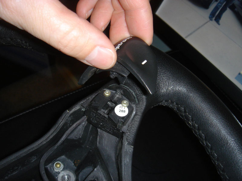

Here is the broken button:
(edit - resized image - Loren)

Sorry, no PN but your dealer would be able to price it. $300 seems waaay too high. I'd just return it and look elsewhere. I had an issue with Road and Race too. I'd not buy from this guy. The fact that you got a broken part tells you he just isn't very good about disclosing things. Majority of use part shops on eBay should be avoided. Most sell scrap that are in bad condition. I'd buy from individuals on eBay next time.
Three spoke Tip wheel? Right? If so, then...
Looks like the switch is: 996.347.831.00 Switch with harness - Retail $95.19 (as of February 2006).
And the right side (?) button is: 996.347.836.00.01C Tip Lever (right) - Retail $24.90 (as of February 2006)
The Left side lever (if you need it) is: 996.347.835.00.01C Tip Lever (left) - Retail $24.90 (as of February 2006)

They sent me a replacement right side tip switch today. I installed it in the wheel and it works fine.
(They didn't charge me for it, either).
Now I've just got to find the time to install it in the car.
