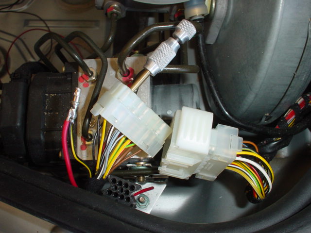

You have the temp sensor in the front grill and 2 wires that run through the trunk to a white 21 pin connector. You need to put 2 female pins in the connector for the 2 wires. The other half of the connector has/may have the 2 male pins that go to the instrument cluster for the temp sensor. The car I worked on had in the connector the 2 male pins going to the cluster. So I only needed to add the 2 female pins/wires from the sensor into the proper slots of the connector so that they mated with male pins when I put the connector back together.
So, the first thing you need to do is to separate the white 21 pin conector to see if there are 2 male pins in the connector that have no mate, as those male pins go to the cluster. If you do not have these 2 unused male pins then I will have to ask Peter what to do next.

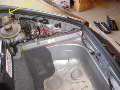

This connector is next to the brake booster on a LHD. No clue where it is on a RHD.
This is the connector on my car as an example. I separated it to get to the horn wire/pin. The purpose of this picture is to show the white 21 pin connector. I do not have a picture of same from when I did the temp sensor retrofit.

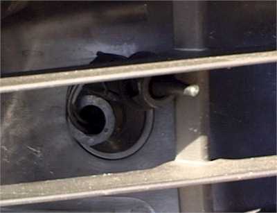

I had the front bumper replaced and the body shop did not fix correctly the outside temperature sensor. It is hanging by its wire inside the right side air intake in the bumper. It is not clear to me how it should be fixed but if I can do it myself, I'll spare me a trip to the body shop which is not close. Can someone post a picture or explanations on how the sensor fits in the bumper

Thank you. By the way I noticed that because after the bumper installation I had a whistling noise at highway speed coming from the front.
Turned out that even after correctly installing the sensor that was not it. It seems that it was the hood which too high compared to the bumper.
Benoit
When the front bumper cover is aligned it takes two people. With the bumper cover mounting screw/bolts loose align the bumper cover and tighten the screws. Close the front hood and check the alignment - if it is not right (even with the hood height) open the hood and re-adjust. Once the hood and bumper cover are aligned you can tighten the other bumper cover screws/bolts.
