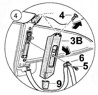

Yes, once the bolt is out slide it up and lift out.
Right but that metal bracket blocks the access to the bolt. There are no bolts visiable with the bracket in place. Thanks again for your help. I have a feeling once this is off I will be done in no time.
Yes. Up and down. The bolt in the belt bracket is always covered by the bracket in the picture. The factory manual pictures that you have attached (thank you!!) are after this bracket has been removed. If this bracket was removed the slider mechanism would be left and I could get at the bolt that would release the seat belt.
Loren, thank you for your help. Over the holiday I called a local shop that installs many roll cages. The bracket that i was trying to remove has 4 clips with two on each side of the adjuster button. You need to take a thin flat screwdriver and pry each one up without letting the other side snap back in. Once I got this braket off I was able to replace the seatbelt quickly.
