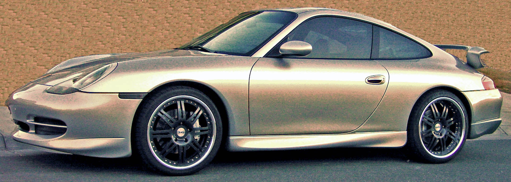

I've got a 99 Carrera C2 Coupe and i'm looking at buying a new set of alloys for it, fancied a set of 'Work Rezax II'
Any body know what size i can fit without rolling the arches.
If i did need to roll the arches how much work is involved ??

On my 996 C2 I installed 18x10's 54mm offset with 285/30's will just barely clear the fender lip without rolling it. When I first got the wheels, I didn't think they were going to clear, especially with my H&R springs. I removed the strut on one side, bolted the wheel/tire back on, and lowered the jack to let the suspension swing up through it's arc. Turns out it clears by something like an 1/8 of an inch.
On my 99C4 i went up to a 19x8 in the front and a 19x9 in the back with no issues at all. I believe they are a 32mm offset if i'm not mistaken
