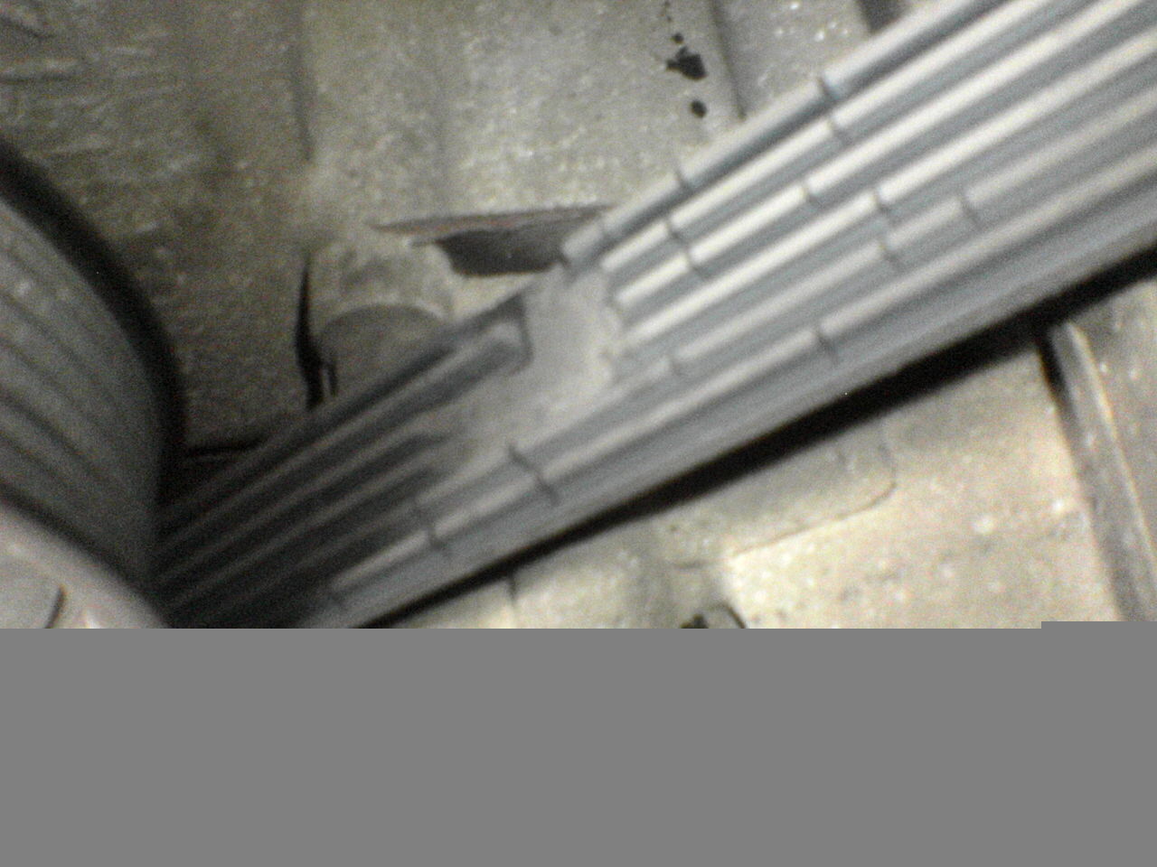

ITS a TIPTRONIC .... I have open the engine to check the belt and I saw this and I think its the thing that was makeing the sound .
ITS a TIPTRONIC

Thanks for ur help and sorry for the lack of info on my first post .you did see the pic . tell me what do you think. how much does it cost to replace the belt.

Does your car have air conditioning?
Is it RoW or US/Canada? (these make a difference in the part number as the belt for A/C is longer)
It does have air conditionin but the AC motor is going bad so it does take some time to run but everything else is fine .My car is US model and i am not sure if this belt for A/C or not but you could see it by removing the compartmant behind seats . the one you told me to check. (ITS THE polyrib belt)

You should have started the car with the belt off to ruleout the pulleys and A/C, alternator, and water pump. It is okay to run it for a few seconds for that test.

the sound from the car came before changing the belt .I gave the car another go and I tried to start it and it did start .but the sound was there so I parked somewhere vary close to where it broke and I opend the engine to see if the blet has any cut and quess what I found a big spot were just falt so I thought it was the belt that making all that noise so I did replace myself and some friends.the car does start but the noise is just there .the last time I serviced the car the guy from porsche told me that my AC is going bad but I did not replace it cause it works most of the time.
