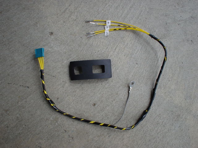

You have to make up the wiring harness using the VW wires and BMW connector. It takes less time to do than read about it. I handed my dealer the instructions I printed out, the new stalk for the OBC and the wiring harness I made up and they installed it
The local group has done about 60 retrofits over the years. But never on a tip now that I think about it. The only thing different on a tip is that there will be an additional connector behind the air bag for the shift buttons, if you do the retrofit with the stalk.
I started using the BMW connector years ago when Porsche jacked up the price on the Porsche connector. I bought a bunch of them from BMW so I do not even know what Porsche is using these days. It does not matter which connector you use. I switched to BMW only because of the price.
This is the BMW connector with the VW wires.

I did this on my 2001 911 with tip. Nothing special about the tip other than removing and re-connecting the tip wires on the steering wheel. I used the Porsche connector and VW wires. The key to success is labeling the tips of the wires that have to be connected to the car, and soldering the VW wires rather than crimping them. Also, buy some friction tape to wrap around your VW wires, as shown in Tool Pants' photo. Good luck.
