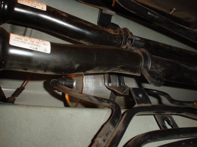

2000 3.2S Fuel filter
Pic courtesy of Tool Pants
Thanks very much but is this at the front or the back of the car? :(
You need to get the PET ( Porsche parts program and data) and the 986 workshop manuals...it covers all the part locations and repairs.
Please tell me how - and thanks very much tool pants I canbnot beleive we could not see it!!!!
The bottom of the car has 3 black plastic panels/covers, front to back.
In order to replace the filter you must remove the middle cover, and it sure helps to remove the rear cover.
This is not easy to do unless the car is on a lift. Or, you jack up one side of the car on your driveway high enough that you can get under the car and do the work.
