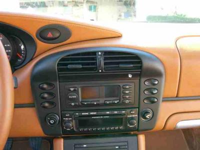

The horseshoe panel prys off very easily without any hidden fasteners to worry about. Just take a butter knife and gently/gingerly prey around the panel slowly but firmly pulling outwards. I usually start at the bottom on one side and work my way around the top and over to the bottom of the other side.
In my opinion, the hardest part is actually removing the little switches, but they too ultimately just pop out.
Remember, always be gentle but don't worry too much about breaking it. Good luck.
