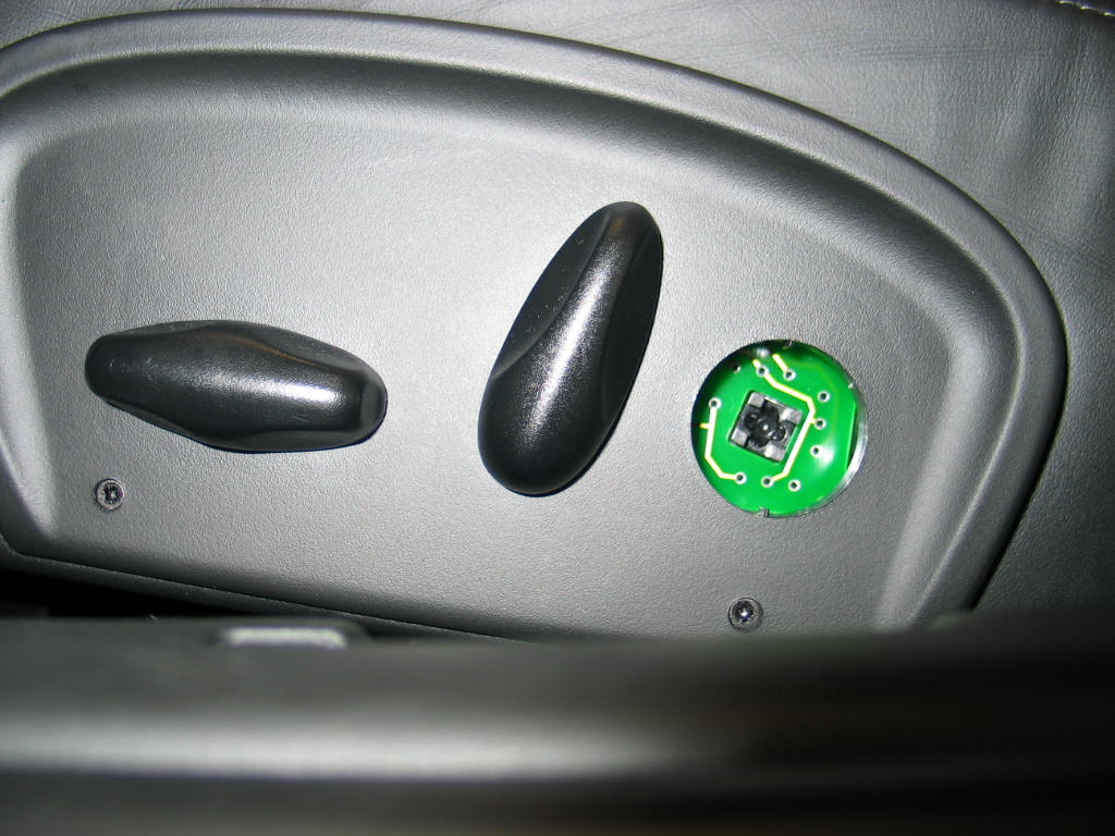

When I looked at the left seat control, there is a bank provisioned for THREE switches but only two are there (apt and recline) but where the lumbar support switch is supposed to be there is only a blank insert.
Porsche insisited their record shows no such option. I took the switch blank cover off and took two pictures, attached. I see a "crown shaped plastic piece on the circuit board of the left seat, not on the right seat.

I'm still confused. From what I can see without taking the seat apart, I have item 9 but not 16 (which I take is a switch). In 16's place, there is a flat black plastic cover. I cannot tell whether any of the other parts are there. I took the switch panel out and looked at the back, and can't figure it out.

can you pop your cover and take a pic?
i have this same option on my car that I just bought a few months ago and always wondered where the lumbar control was. I have that same black cover in the same spot behind the other seat controls. I will pop mine off tomorrow and see what is under there.

David, mine looks exactly like yours. I am not sure know exactly what the 537option is. If it is lumbar support, why isn't there an adjustment knob or button? The owners manual shows a button for lumbar support adjustment. So what is the purpose of the option without the ability to adjust?

It is my understanding that after designing the 996 power seat to have power lumbar support, Porsche quickly discontinued this feature, and ceased installing the control (hence, the blank cover on the seat side) .... due to the system being frought with problems.
