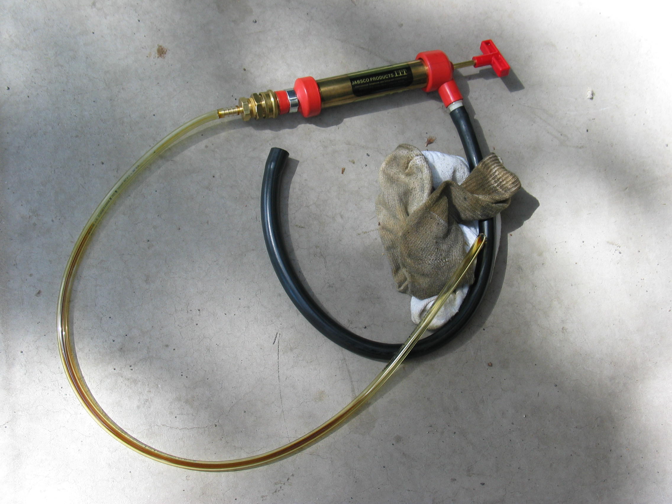

You can also use a hose and pump out some from the dipstick. Hose and simple hand pump can be had for $10 at Home Depot or Kragen.
That is a FANTASTIC idea :clapping: ! I have a setup like that for changing the oil in my boat engine and I'm pretty sure that it will work on my 911. I will give it a try. THANK YOU, THANK YOU!

I have a fluid extractor that I bought online (griots garage?), it goes thru the dipstick tube & can extract oil... I did this a couple of weeks ago, works like a charm.

Well it worked OK. I needed to pump quite a few times to get enough oil removed. The problem was that the clear tubing I bought to go down the dipstick tube was too large in diamter to go all the way down. It did make a good seal and I was able to suck the oil up and out with the pump. I did have to buy a few fittings at the local hardware store to be able to attach the clear tubing.
Here is a pic of the contraption:post-1644-1149118114_thumb.jpg

The hand pump came with my boat. I think that you can get them for 10 to 15 bucks at marine supply stores and auto parts stores. The brass fittings I used to adapt the pump for tubing small enough for the 996 dipstick was another 5 bucks.
Personally I think having one of these little jewels is a must for do it yourself oil changers. I'm sure I will use it again.
