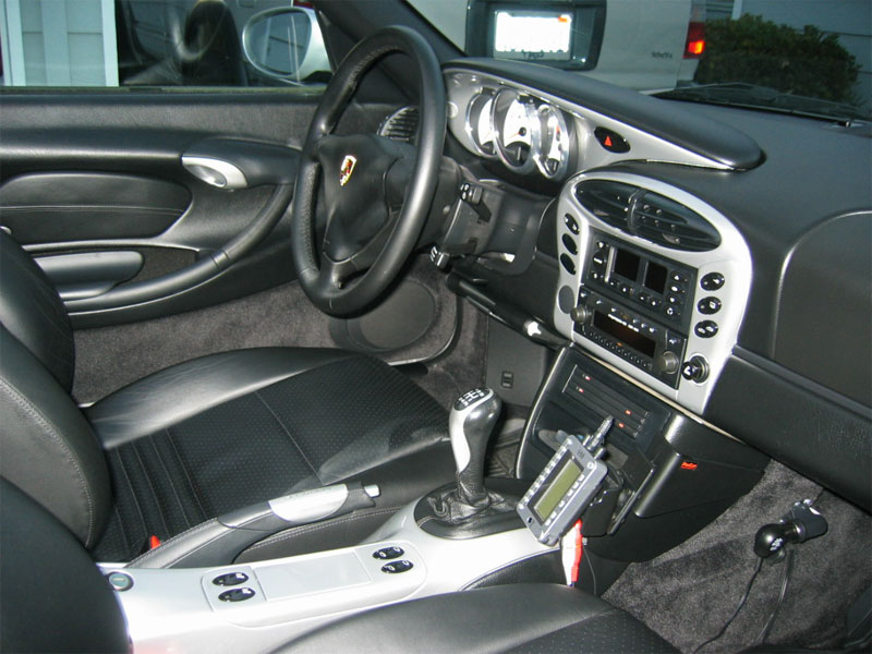

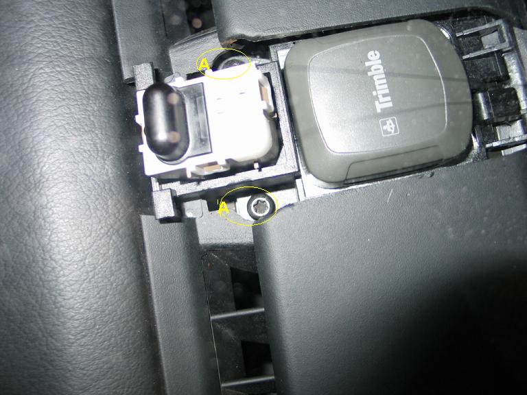

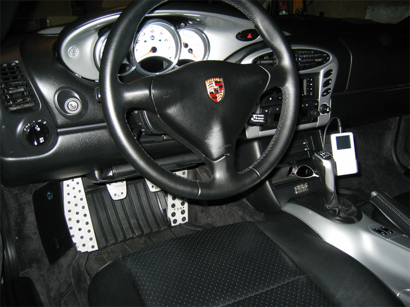

I actually have the Delphi Roady2 XM Radio and mounted it using the existing Proclip mount for my iPod. To do this, I used the swivel mount that came with the Roady2 and stuck heavy duty velcro that you can buy from Home Depot on the mount and other half on the back of the Proclip swivel mount.
http://www.proclipusa.com (I ordered the 3rd generation 20GB iPod swivel mount). You also need to order the mount that's used for our 986/996 center consoles.
Instead of just placing the XM radio antenna on the dash, I wanted a cleaner look, without all the wires hanging all over the dash. I installed the XM radio antenna that comes with Roady2, right underneath the front dash IR sensor cover and routed the wire down the center console. As for power, I decided to buy another cigarette lighter socket and mount it to the side of the center console. I found that the cigarette lighter socket on our front console can be pretty loose for our power plugs (V1, iPod, Roady and etc..) especially on twisty roads.
The nice thing about the Roady2 is that I can use it in multiple vehicles and the Proclip mount can be used for both the iPod and Roady2.
- Ray W.

Oh, I forgot one important item. I'm using the aux port on my CDR 220 for the best sound clarity and noise filter from Radio Shack.
