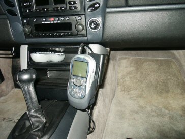

I have installed my XM 2Go using a bracket call "ProClip". Bought the Aux Input cable from Crutchfields, the GLI form Bestbuy (you will need this if you permanently attach the power) and the ProClip from someplace on ebay. I used the XM 2Go lighter adapter, took it apart and used the guts to permanently attach power to the cell phone connector.
See pictures of finished install.
To get to the phone connector, you remove the plastic piece on the console (the area that the "Proclip" is attached to) by pulling the back edge (that is the edge towards the front of the car) sideways and forward. Then remove the carpet piece by pulling from the back edge sideways and then back.
Just looked and I actually bought the Proclip right from their website at http://www.proclipusa.com/
