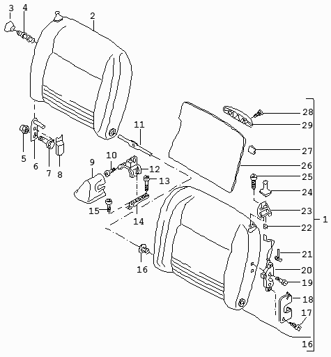

Remove the plastic covers from the pivot points and then remove the bolts.
The plastics covers on the inside or on the outside? Tried taking the inside cover off, but wasn't sure how to do it... force, or is there a more subtle way?
  • 3 months later...
  • 6 months later...
I was trying to remove the plastic cover at the pivot points (item #9) but had differcult. Does anyone know how the plastic cover hold to #12?
EDIT: I got it. It is just push in and clips on the the rod. I just need to force and pull it forward.
