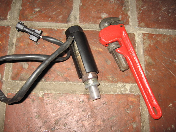

You can access the o2 wires easily if you remove the airbox. This is easy to do. The o2 socket may not remove the sensor if it has been in there a long time. I had to replace 3 of the 4 sensors due to aging at 90k miles or so. The socket just rounded the corners on one of the sensors, but I was able to remove it with a 6" pipe wrench (don't laugh) with ease.

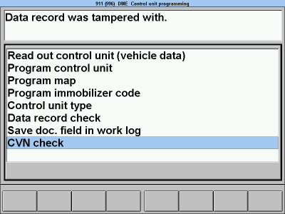

Took the car to the dealer to get the TSB DME update. The DME software would not allow the DME to be updated. The upshot is that the dealer is ordering a new DME and replacing the old one under the emissions warranty.
The tech asked me if the DME had ever been flashed using 3rd party software. I've never done it but I'm the 2nd owner so anything is possible. Is there any way to know if the DME has ever been modded? Apart from the DME being defective, is there another reason why the software would reject an update?

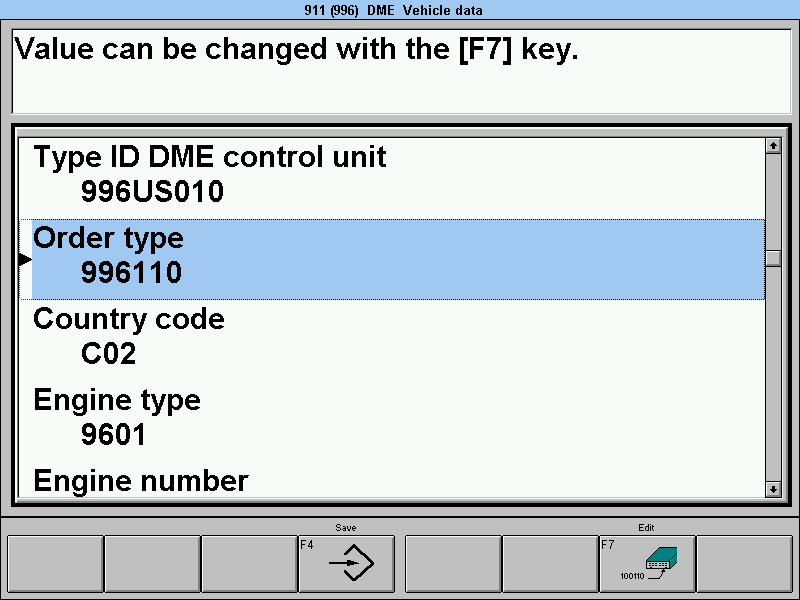

On 2002 and newer cars the dealer can run a test with their PST2 or PIWIS and it will tell them if the DME has been changed.
We've seen a number of cars that you can not program - but because the model type was never entered in the DME section.
They might want to double check that before they order a DME.
