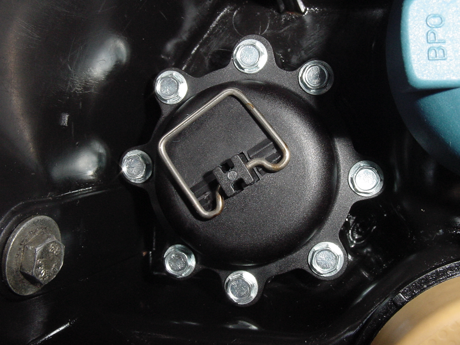

#14 Loren
Loren
    Porsche Nut
  • 29,945 posts
  • From:Roseville, CA
Reputation: 1,487
Outstanding
Posted March 23, 2010 - 06:30 PM
- Zoom Active -
  • 0

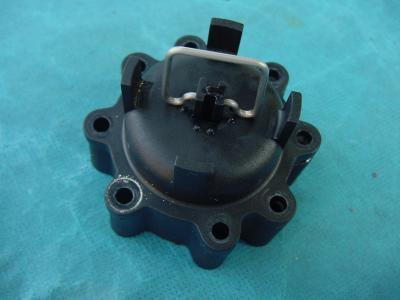

#15 1schoir
1schoir
    Contributing Member
  • Contributing Members
  • 2,774 posts
  • From:Freeport, New York
Reputation: 127
Outstanding
Posted March 23, 2010 - 06:34 PM
ok, i see a pin that loosens a plactic that locks in the middle if you put it in that position? is that the open position when its in the middle? thanks
zft:
Here is a photo of the bleed valve in the "normal" position:
- Zoom Active -
Here is the position that you should put the little lever in to keep it in the "open" position, so that you can ride around with it like that for a few days to bleed the air out:
- Zoom Active -
Regards, Maurice.
  • 0
