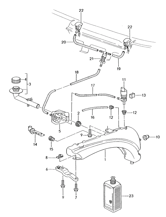

Does anyone know how to replace the windshield washer reserve tank in a Boxster S? Is it something I should be able to do myself? I searched everywhere on the web and couldn't find anything (only one post on here, but the links were broken). If anyone could help I'd really appreciate it.
Are you replacing because it's leaking? If so, the reservoir may still be fine. I thought I had a cracked reservoir, ended up being the grommet that fits between the reservoir and the filler tube had gotten knocked *into* the tank. Took it all apart, fished the grommet out, reinstalled it correctly, and no more leaks. :)
Hope your solution was as simple (and at no cost) as mine. Good luck!
Thanks for the welcome. This should be simple enough to fix, but yeah I'm about 97% sure its cracked just because it pours out as I am refilling it. No idea how it happened though, maybe extreme cold?
Sometimes its just the filler tube has come out of the tank, try some duct tape to keep in in place. :)
