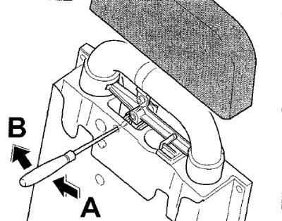

Insert a screwdriver into the hole in the module and press it against the top edge of the pawl. Press the screwdriver to the right arrow A and hold it while pressing up in direction of arrow B. The roll-over protection system is released.
To reset just push them back down until they latch.
I do this for all my Track events, blows some people's mind out since they go to the dealer and are told "it is impossible". Then they watch me get a screw driver and pop them up in about 2 minutes. You first have to lower the rear seat backs, and remove the carpeted panel behind the rear seats - 2 phillips screws and done.
You can also push down on the latch from the top with a screw driver, same result. But I would first follow the instructions above until you understand how the mechanism work and how else you could position the screwdriver. Also, don't have ANYONE looking down "to see how you do it" when you are releasing them, they will get hit on the nose when the bars pop up.

You have hold the screwdriver to release the latches as I posted...
