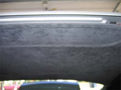

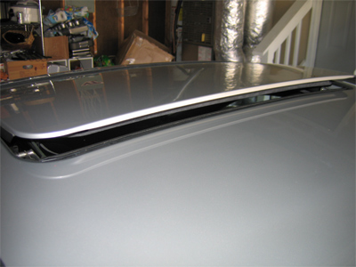

The TBS in the end did not help the problem I had.
So I tried putting felt pads on a couple of soft foam pads. Its in the area between the fabric and the sunroof.
I had to tilt up the sunroof to do the back side and open the sunroof half way to do the front part.
It worked like a charm. The car is now quite. Thank God.
Also I tighten down the speakers, It seems that the screws were a little loose
Edited by evansaero
can you take a pic of where you placed the pads? I'm having a similar problem and would love to eliminate it. TIA.
Sure I'll do that now
OK Done deal. I hope this helps.
I think the pictures explain themselves. I would have use black felt but Lowes didn't have any. On the last picture you have the wind breaker tabs. There is one on the front and rear. I put felt down next to the old felt. It seems that the old ones are worn out and I think some banging noise was coming from there when going over bumps.
Best part is it's not the cleanest job but no one knows that but me. Well now everybody :lol: :lol:
Edited by evansaero

I have the same problem with the sunroof. If I apply pressure to the sunroof from the bottom while driving, I don't hear the banging sounds when I go over bumps. I tried felt pads in the locations shown in the pics, but it didn't help. Anyone else solve this problem in a similar way?

Ok, I tried felt in the same places as the pics above and it didn't work for me. I also tried it in the place I think fastboydave is referring to (but I'm not 100% sure I get what he's saying). I put a single piece of felt in a place that doesn't seem like it would do the trick and it seems to have solved my problem very well. Honestly, I don't understand why this works, but it does.
