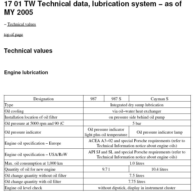

I have an 07 Boxster S with 7500 miles on it. I changed the oil/filter and refilled with 7.75L of oil as the manual said. After waiting about 15 mins, I checked the oil level and the indicator only lit up the first bar above the bottom arrow. I then added the remaining 0.25L, waited another 15 mins and the indicator then show two segments lit, but not up to the top arrow. I really don't feel like buying another liter of oil only to use another 0.25L to reach the top arrow. Since then, the indicator still shows the same level -- have 7900 miles now.

The Manual is correct at 7.75 quarts. Each bar is about 8 ounces of oil. This is for the 987 Boxster.
Just check the oil level each morning, and add to the bar just one below full. It takes a long time for the oil to register...more than 15 minutes.
You really want the oil as full as possible, without overfilling, since greater than 50% of the engine cooling comes from the oil.
The level changes depending on whether the car is warm or cold. If you check the oil in the morning before the car has been run, the oil tends to read lower than when its checked after re fuelling. Seems odd , and i recollect there is a TSB about recalibrating the oil level indicator , so maybe there is an issue. Providing the oil level always reads above half way and never above full , I wouldn't worry too much about the graduations between. I also noticed when the oil is full , you are more likely to experience smoke on start up.
Thanks for the replies everyone -- I going to check the level after I've driven the car (hot oil) for curiosity. As Loren pointed out, the service manual says the same as the owner's manual - 7.75 L. I'm running Motul 8100 Xcess and it cost me about $9/L so I'm not going to open another L just to add a little oil and have a good L of oil hanging around for half a year.

The only way to get an accurate read on the oil level is in the morning, on level ground, just before start-up. If you check when the oil is hot, it will almost always say full.

OK, I've been harassed enough (in a good way, though). I've added more oil to get to the third bar. I added twice in 100mL amounts, so 200mL got me there. I'll watch it for a few days. Since this is my first Porsche, I'll probably be asking more anal questions until I learn the car. Looks like the prize goes to Loren for recommending 8.5L.
