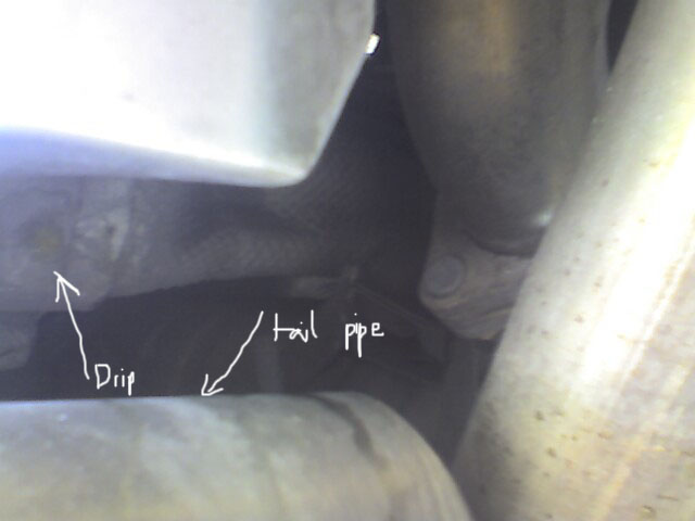

Hi,
I walked out to my car at work this morning, after having driven in 14 miles from home a few hours ago, and there was a puddle of a thin, oily fluid under the drivers side tail pipe. Looking closer, it appeared that there was the thin, yellowish oily fluid dripping from the underside of the tail pipe, not from out of the end of the pipe, but having dripped from above it. It appeared to be dripping from some body work above in the pipe, but I haven't been able to see exactly where from yet.

Hi,

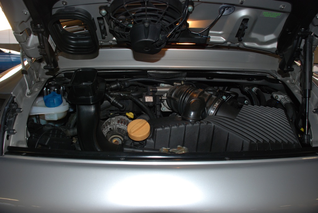

Here it is, all installed :
