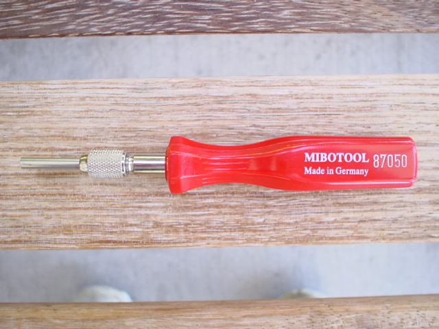

4. Is the medium SIR pin removal tool, p/n 9701, the one I need to remove the pin 2 from connector X1/2? I searched past messages and that sounds like the Porsche 87050 equivalent. Can I get it at some place like Fry's?

That is the one. http://www.renntech.org/forums/index.php?showtopic=3389

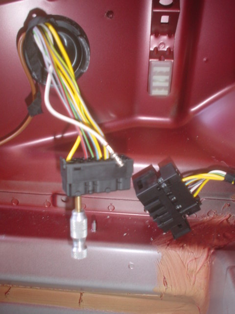

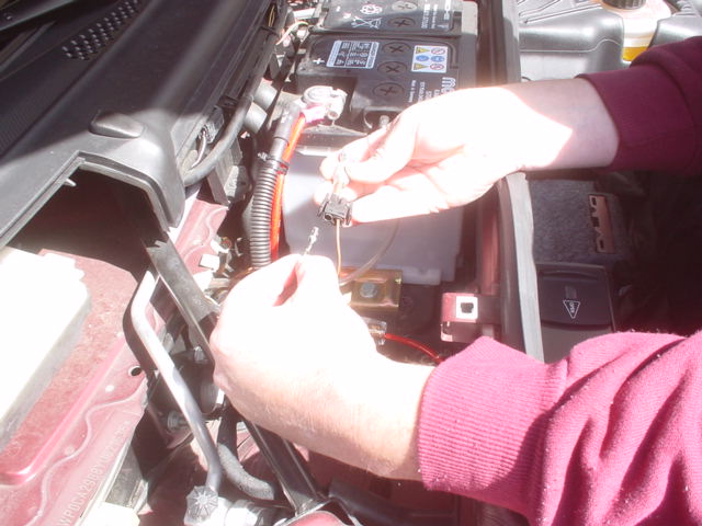

And here it is in action. Removing the pin from the black 21 pin connector and the pin for the 2 pin heated washer connector, during Henry's litronic install. Again, you first must unlock the connector before you can use the tool to remove the pin. You unlock the 21 pin connector from the back, and I think the 2 pin connector from the side. AMP/Tyco calls it a secondary lock. Only after the connector has been separated and unlocked can you use the tool to push the pins out.
And here it is in action.  Removing the pin from the black 21 pin connector and the pin for the 2 pin heated washer connector, during Henry's litronic install.  Again, you first must unlock the connector before you can use the tool to remove the pin.  You unlock the 21 pin from the back, and I think the 2 pin from the side.  AMP/Tyco calls it a secondary lock.  Only after the connector has been separated and unlocked can you use the tool to push the pins out.

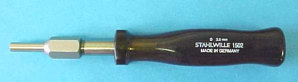

Weird. I checked Samstag Sales which sells German tools and Sir Tools 9701 is listed as discontinued.
Hazet and Stahlwille also makes pin extractors, but they cost more than Sir Tools.
I have never been able to find Mibotool - even asked on the German Boxster board.
