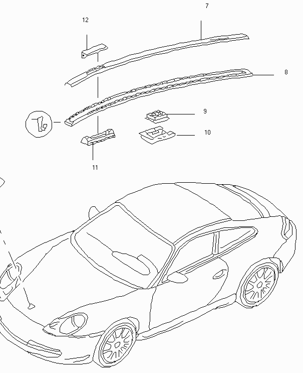

It turns out that it's that little white plastic insert in there that acts like a hinge for the metal flap. When folks put the racks on there, it can break the hings protion of that white plastic insert and make it so that the metal flap doesn't seat properly. I guess you can follow the directions Loren posted, take out the white insert, and replace it with a new one that allows the flap to lie flush.
Is there a part numbe for that white doo-dad??
Edited by Chuck Jones
Item 7 - 996.559.401.00.G2X Left Roof Edge Strip (unpainted)
996.559.402.00.G2X Right Roof Edge Strip (unpainted)
Item 8 - 996.559.721.00 Left Gasket
996.559.722.00 Right Gasket
Item 9 - 996.559.405.01 Adapter (10 per car)
Item 10 - 996.559.403.01 Clip (10 per car)
Item 11 - 996.559.729.00 Bracket for flap (4 per car)
Item 12 - 996.559.501.00.G2X Flap Front (2 per car)
996.559.503.00.G2X Flap Rear (2 per car)
