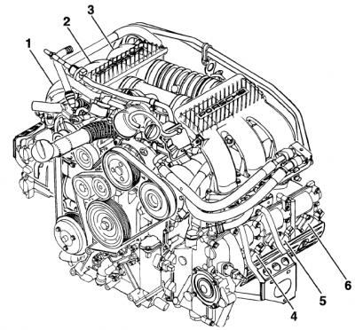

  6. There is no TSB on the Oil Separator - even though these have failed on a number of cars (cracked). The oil separators (there are two) are in the crankcase. To get to them you would need to remove the engine sump cover - and then reseal it after the inspection/repair. In the image below they are numbered 9 and 13 (image is 180 degrees rotated from how it is in the car).
