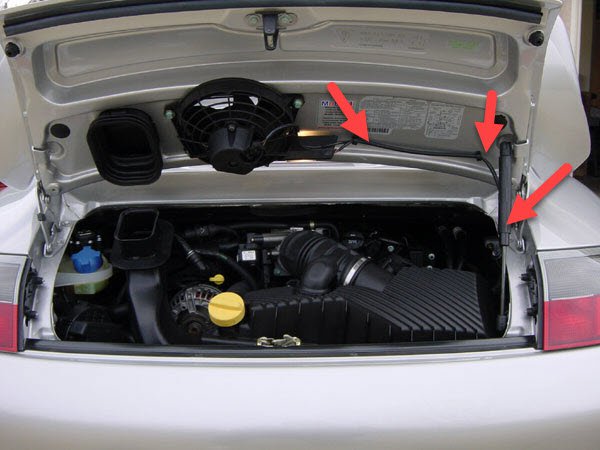

  15. The photo is of the rear of my 996 - with aerokit. The wiring diagram shows that it would still be the same connector regardless.

  17. Follow the cable down to the chassis - right behind the hinge/support.
  18. Sorry, just saw this. VS 13 is simply a junction of several wires. It is more likely that your issue is in the X23 connector (from my experience). If you follow the cable from the light down from the lid to the car body (on the right side as I recall) then it will be the connector that the fan and 3rd stop light plug into. Look for corrosion, bent or damaged pins, or even broken wires.
