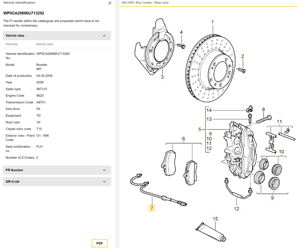

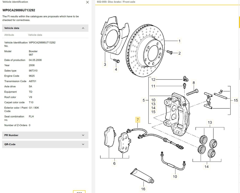

  21. Left Front sensor -- 997 612 755 01 sender wire (pad wear indicator) US MSRP $59.28 Right Front sensor -- 997 612 757 01 sender wire (pad wear indicator) US MSRP $59.13 Sensors include cable and connectors... item 7 Rear (same for both sides) -- 987 612 676 02 sender wire (pad wear indicator) US MSRP $35.64 You can get better Porsche parts pricing through Sunset Porsche (board sponsor): Factory Porsche Parts, Tequipment and Selection (Boutique) Phone: 1-888-502-5927 Email: http://www.sunsetporscheparts.com/contact-us Genuine OEM Porsche Parts | sunsetporscheparts.com | Sunset Porsche Parts WWW.SUNSETPORSCHEPARTS.COM Find genuine OEM Porsche Parts direct from sunsetporscheparts.com at unbeatable prices. Also find Porsche Drivers Selection gear and accessories. Shop Securely Now.
