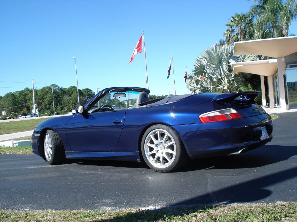

  8. My spoiler is a factory XAG option code, described simply as "Carrera Spoiler" on the build sheet. Looks like this:
  9. I don't mean to start an argument with this, but just adding some info. My '04 Cab has the optional factory side skirts and rear wing. I have studied the 2004 Cab option list and apparently no front spoiler was available so this is as close as the original purchaser could come to buying an "aerokit" for this car. Porsche must have considered this combination of parts OK w/o a front spoiler. I also question whether the aero imbalance issue is relevant at normal speeds and might only come into play at Autobahn speeds (as in 100 MPH plus)?
