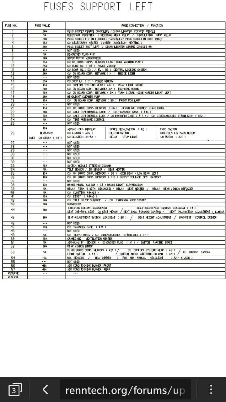

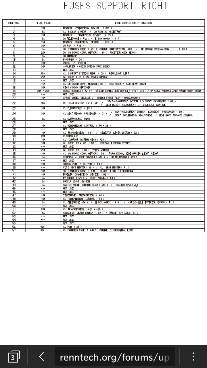

  4. After you changed the battery and cleared codes and gone for a nice driving cycle, recheck the codes and clear once more. Recheck codes again and then move onto fuses for TC left side fuse support check fuses 22, 23 47. Fuse support right check 7, 40, 57. the control module is under the passenger seat as well as the transmission controller module. Some time the get filled with fluid from the transfer case apparently!
