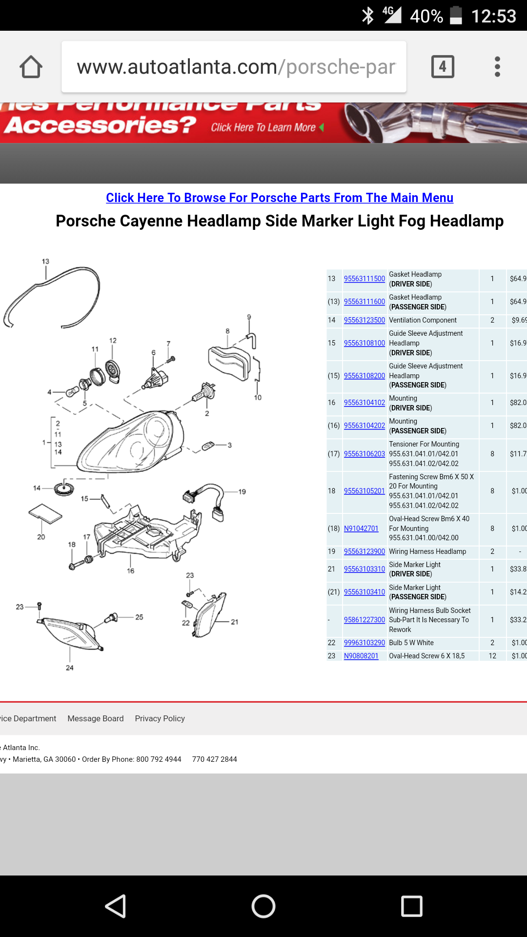

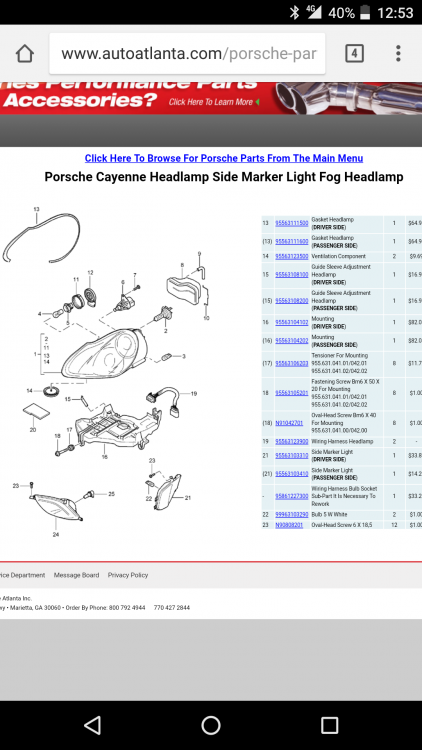

  11. Probably will need to replace part 16. Unless you can diy Fix It with something.
