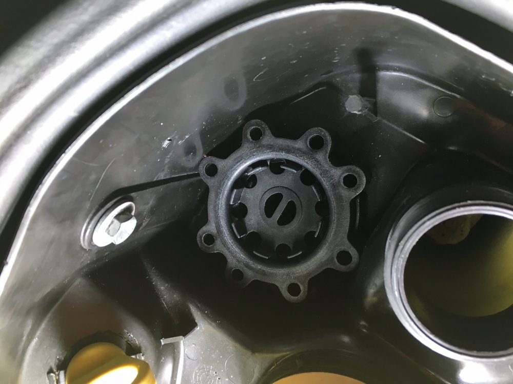

  17. Hi Guys I thought of changing the o-rings in coolant bleeder and order two o-rings small and large. But once I removed all the 8 bolts around the bleeder I got the cap our but I don't see where the o-rings go. I even doubted if I my Boxster has the o-ring type of bleeder. Attached are the pictures please help me get to those old o-rings if at all they exists in my car.
