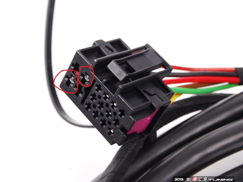

  2. Hi Guys, I ordered a hitch off ebay with harness for a good deal but when I received it, the black connector on the harness was broken. The pins on the wiring are pretty stiff and stay put when I just attach them to the wiring terminals on the tow module. Given how well they seat like this, I figure I'll just make do with what I have. Can someone please let me know which wire goes in each spot for the connector (circled in red)? From there, I can match them up to the tow module. TIA!
