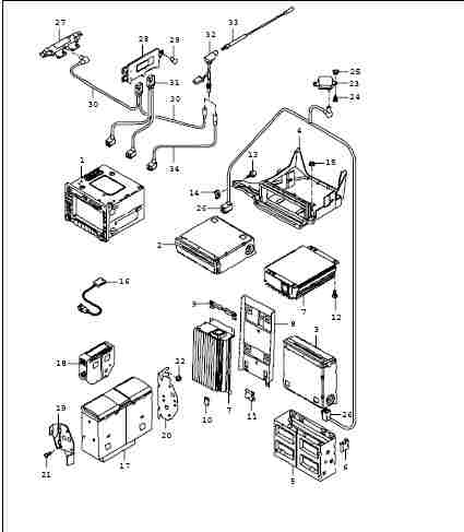

Cars that are US spec and have the additional carbon filter for the fuel tank or are the 4wd model use a different Navigation unit thats vertically mounted in the front trunk. As I tried to describe in earlier posts , the MOST ring is directional , so there is an IN and an OUT on the plug that goes into the rear of each device. Having installed the very same (dual FOT) dension myself I'm aware that when fitting the unit with a change over switch , the fibre optic cables need to be altered from those of standard. Simply unplugging the dension isnt going to help , as the loop wiring is modified to allow the CD changer and Dension to sit side by side. You will need to identify the original cable from the PCM and plug this into the CD changer and then connect this to the nav which then in turn connects back to the PCM. Its difficult to explain in words , but if you download the user install guide from dension .com it has a diagram that makes better sense. I dont beleive this is the root cause of your stuck DVD in the nav drive, I suspect its more a case of the disc being the wrong way up, the wrong type or incompatable software with the rest of the system. I know of a couple of other cases where the disc became "stuck" in the nav drive , none were able to eject it and ended up with a new drive. The Navi drive should be able to eject the disc , even with the main PCM off , therefore I'd suggest that removing the power to the rear of the nav and holding the eject button when reconnecting (after a few minutes ) may be the only possible solution. What seems stange in this particular case is that the CD and nav are in different places to expected. Furthermore the PCM doesn't display a "target" value for the navigation. The target is configured using the PWIS and held in the gateway of the car. The navigation option is not standard with PCM on the 997 , so it may be that this is a later addition. When coding the new navi drive , if the car isnt subject to a vehicle handover procedure , the updated setting (ie the the nav) can be lost if the power is disconnected from the battery. Is it possible that the nav was fitted afterward and either incorrectly placed in the MOST loop or never coded ? The nav units have different codes for vertical versus horizontal mount , so incorrect installation may well cause issues. A look at the vehicle options codes in the front of your owners sevice book will validate if this was factory fittment or added later. The first pic shows the 997 TT which is 4wd , as you can see the DVD drive has two possible locations each of which has a separate part number , the CD drive in this case is fitted vertically also. The second pic shows the Gt3 which has the option for either a vertical or horizontal DVD drive. The CD changer on most 997 is normally a horizontal mount. -

The CD changer and NAVI drive are in sequence on the MOST ring so the connections very close to each other. Is it possible when the i pod interface was being installed the wrong MOST cable was taken out of the rear of the DVD Navi rather than CD changer ? The I pod interface mimics the Cd changer so it must replace the CD changer in the loop. Dension offer a switched interface whereby the CD chnager can remain connected and via a switch on the aux input module you toggle between dension or original CD changer. The MOST cables are also directional , so when you fit a new device there is an IN and an OUT most fibre optic to the unit. If you look closely at the plug you can see a direction arrow. The MOST connectors come in two forms , one is pre wired , the other is user assembled , as a result its possible to get the wires in the wrong chambers and directions incorrect. The OUT wire from one device should correspond to the IN wire on the next device in the sequence etc. -
The PSE will make a different sound depending on the load on the engine , when on the overrun you get less of a boom but more crackles and pops , when under load climbing a hill the engine works harder and you get a deeper more agressive note. Under steady state cruising with light throttle the exhuast can almost become as unobtrusive as the standard item. Wind the revs above 5k and you get a loud agressive bark. Regarding the activation of the PSE , I made up a custom loom to allow a simple switch to activate and de activate the PSE without the DME overide between 20 and 40 mph. If you are activating the PSE via the SPORT button currently , the bypass switch allows you to have the PSE always active without the need to reset every time you start the car . It also allows the PSE to be active without the sport mapping of the throttle and PSM. The loom I made is plug and play , so you dont need to modify any of the existing wiring , making it completely reversible. The switch can be mounted under the handbrake or inside the ash tray.
As suggested you need to check the navigation and PCM software versions are compatable and the disc is correct for the software versions. Start by pressing the MAIN and TRIP buttons together and then write down the software version displayed on the top header bar and then select each of the displayed components to reveal its individual actual and target software. If you can post these back on hte forum we can give you a better idea of where the problem may lie. To reset the PCM/ NAV you can either remove the fuse or press 1 , 4 and 8 buttons simultaneously. If it gets to the point of replacing the PCM , you would be better to consider an aftermarket head unit with navigation from Kenwood or Pioneer. Not only are the navigation updates cheaper and more readily available , but the unit will have bluetooth connectivity and MP3 functions already built in , rather than expensive add ons as with the PCM. With aftermarket fascias available and custom welcome screens , its easy to get a very authentic looking install that woul fool all but the porsche techs.

If you press MAIN and TRIP buttons together you get a service menu displayed. Each of the items on the MOST (fibre optic) ring is displayed with a target and actual value. If there are items in the wrong sequence or with faults there will be a warning triangle next to the device and missing parameters. Typically if an item is incorrectly installed in the loop it affects other devices as well , as there is a set sequence for each control item ( CD , NAV, TEL etc) that must be followed. If the Navigation unit isn't showing a fault on this menu , then its correctly located on the MOST loop. The Navigation unit DVD drive has permanent power , whereas the MOST loop is only functional when the PCM is active since this is the hub for the system. Therefore ejecting the DVD should not be dependent on the MOST loop being active. There is a small paper guide located on the inside of the fuse box cover in the forrwell. This explains the location of the fuse for the PCM and navigation DVD drive. If you pull the fuse , allow a few minutes before re instating and then press and hold the DVD eject on the NAvi DVD player you may have some success. -
Pcm Problems
berty987 replied to oskibear's topic in 997-1 Series (Carrera, Carrera 4, Carrera 2S, Carrera 4S)
Sounds like someone got the CD changer and Navi mixed up and put a CD in the DVD drive or put an old version map DVD in the unit before selling. The DVD unit has permanent power and a wake up from the PCM. All I can suggest is holding the eject button whilst re instating power to the DVD drive by replacing the plug, you may be fortunate that this allows the unit to give up the disc. I've had a few close calls with the PCM where an incompatable disc has become "locked " in the drive. In most cases a bit of patience has paid off where the disc ejected after holding in the eject on power up. There is also a reset procedure you can try which involves pressing and holding 1 4 8 together. Porsche approach will be labour and parts to fit a new DVD drive. -

There is avery good write up on retro fitting the PCM on both www.planetporsche.net (US based) and www.boxa.net (UK based). The Bose amplifer on a 987 fits in the front luggage compartment and is hidden by the panel that the warning triangle sit on top of. There are two plastic quarter turn screws that hold the panel in place, the amp sits behind the panel. As I'm sure you are aware there are different MOST fibre optic cable options depending on the components fitted to your car. You will need the MOST cable suitable for a car with BOSE and Navigation as the cables are different lengths . It's also important that you connect the devices in the correct order , as the MOST loop is a ring circuit and each device has a designated position in the sequence. Each device has an IN and and OUT cable that needs to be connected to the correct device in the sequence prior and after , if the sequence is incorrect the device will not be recognised and the whole loop can malfunction. I assume that you have matched the PCM version to the navigation DVD drive as these have different hardware and software levels. If you have any more questions drop me a line.
