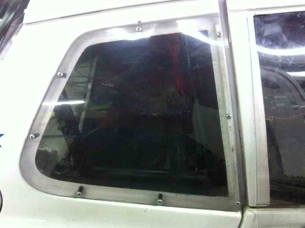

  15. I know there are lexan windshield and hatch glass available that can be urathaned in.. Rear glass separated from frame (this part is challenging) then lexan installed to the frame ( urathaned / fasteners ) The guys here usually do it off the car..... We made rear quarter windows that just screw in flush for aero and easy removal... I recommend pre-drilling any holes through acrylic/lexan so it doesn't split when putting through a fastener.. You can paint a black frame or vinyl for looks... I recommend painting from the inside out... Note clubs may sanction rules for braces on plastic windows and possible retaining clips for front windshield Cheers
