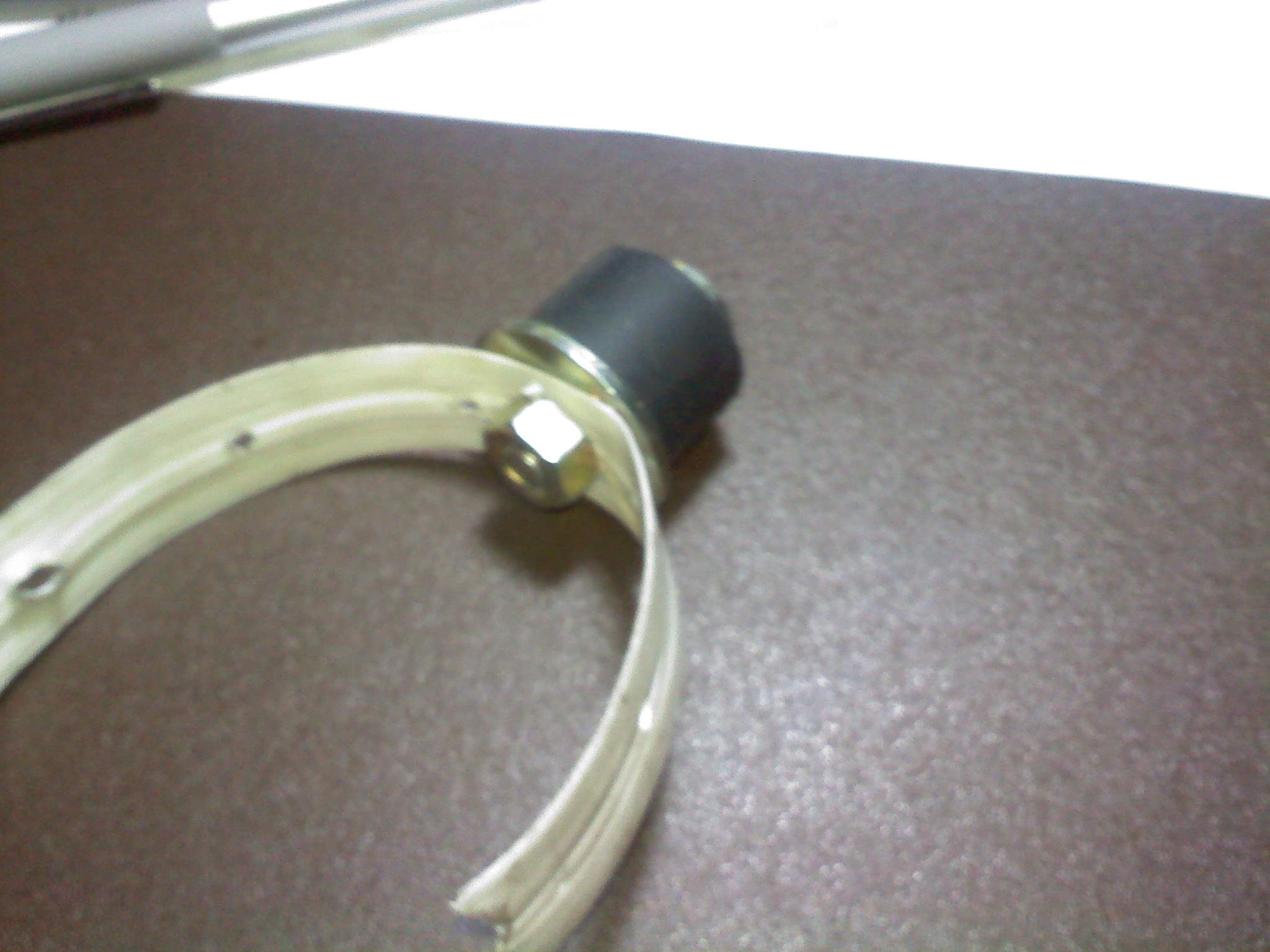

  2. You need to replace the seals on the spark plug tubes, it's an easy fix. Hardest part is getting the tubes out without cracking them. If you hit a auto parts store and pick up a 1 to 1 1/4 rubber expansion plug, you can pop it in and tighten it up until the tube spins and then just pop it out. If you have one tube leaking, chances are you have others too. At 90K I had 3 leaking.
