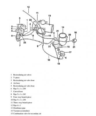

  6. Can you be more specific about the hose. Are you talking about a sense line on the diverter valves? If it is a sense line, page 611 of the repair manual got a good routing of those lines....There is also a routing of the sense line on a sticker under the engine compartment cover.

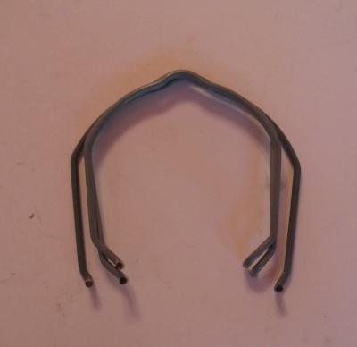

  20. Just for your info. I have found, the hard way, there are 6 different sizes of clips on the TT . The numbers are 996-106-802-10 (-11,-12,-15,-16,-17) depending of the location on the car. Per example the -11 is a little smaller than the -10 ???? But the -12 is a lot bigger....I've made a mistake between two sizes (-10 and -11) and the clip did not hold properly.... Also i've purchase new ones and the clipping action was more firmed....In your case we are talking about -15 and -17, hope they were not misplaced...
