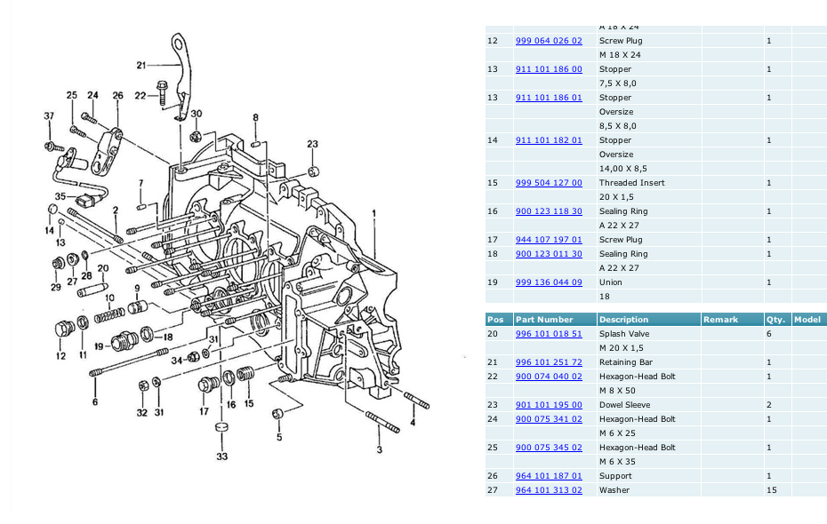

  11. Just did my oil change before winter and found out that I got the wrong seal for the crankcase drain plug. Can you help me and give me the right part#. Thanks a lot, J.P. Is it item #16= 900 123 118 30
