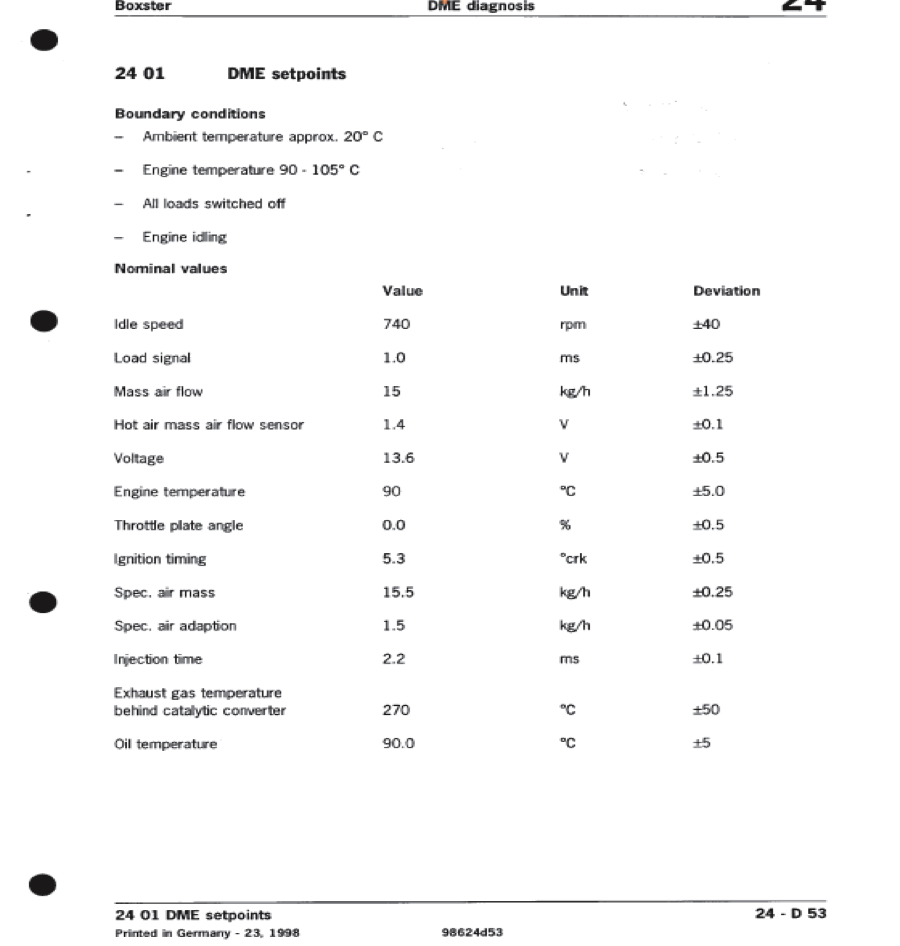

  12. Loren I observed -1.0 for the Spec air adaption with no change with rpm Any idea what could cause this deviation from nominal. I have been getting fault codes P0410 and P1411 for the secondary air injection. The pump runs ON STARTUP when the engine is cold then shuts off. But the pump sometimes comes back on after driving when I come to a stop and idle. This turns on the Check engine light sometimes. I have changed the MAF and the O2 sensors. They both look like they are operating normal on the Durametric Actual Values
  13. Hi I have a 1997 Boxster tiptronic and I was looking at actual values with a Durametric tool and with engine warmed up at idle the Spec. Air Mass of 15.5 Kg/h seems normal but the Spec. air adaption reads -1.0 Kg/h and is not right as the manual says 1.5 is normal. Any idea what can cause this?
