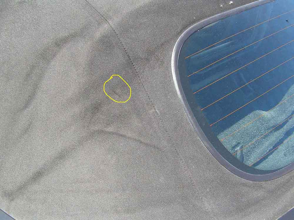

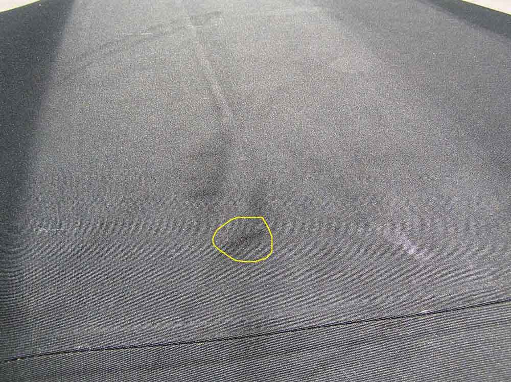

  5. CA boxster I have checked the way the top folds and didn't notice out of the ordinary fold patterns. There are a couple of stains on the top (the car had 4k mi on it when I bought it. dont know what the previous owner did with it. He was 80 !!!!!!) That's was started me on this stress thingy. Cause I dont find anything that might have caused them. One body shop I went to suggested I use some foam pads where the support rods were, that way I reduce the stress on the canvas and also the sharp folding. I was going to try that. The weather here is really dry and he said that that might definitely cause this. Hopefully reconditioning the top and using the foam pads should take care of this problem ... I HOPE Djantlive Not soo lonely .. they do sell quite a few cars around this area. Just not that many where I live !!!! ;) So I'm not that lonely after all. But where I live (about an hour drive from the dealer) I am the only one with this car. Makes it real difficult to evade the cops ... THEY JUST KNOW WHERE I LIVE :((

  7. These are two stress marks that are really visible. The others are a little hard to see. they look a bit worse in person than in the pictures

  9. The mark can be seen (atleast the ones I know of) mostly towards the rear end and around the glass window of the car. I had the dealer check for any sharp objects or the support rods that might be causing this. They found nothing. They suggested that I use some kinda foam pads at the points where the support rods are present to reduce the stress to the canvas material itself. Other than that they said that it was usual wear and tear issue. And I didn't know that Raggtop was that costly. The last I checked it was about $20 for a can.
  10. I have and 04 986 base. The water no longer beads on the top. It beads for a couple of seconds at the most and gets absorbed (even in light drizzle). My question is can this be rectified by treating the top with something like raggtop or something. Also the top shows a lot of stress marks which make those spots really thin like its wearing off. What can I do to prevent this from happening? Also how long do these tops last with proper care in a southern climate
